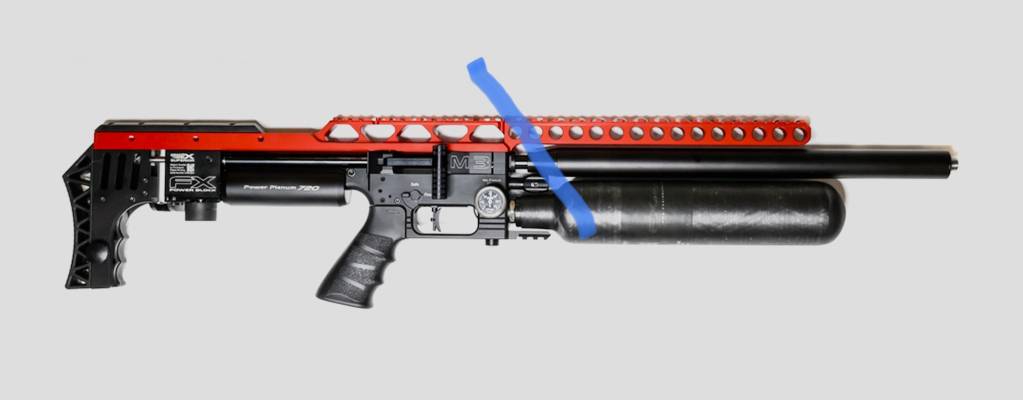

I was bitching about impacts skinny little "frame" or "chassis" is super flexible and make the impact at high power harder to shoot accurately due to flex induced with hold.......well, this thing should fix most of it. Needless to say this one upgrade I had to have and hit the preorder button, still cheaper than a M3 right? Only gripe is the front looks damn ugly! when is the 800mm .25 barrel coming out? LOL!
It certainly is upgrade to me, If you take the impact apart the plate is really flimsy. Fine for pellets or lower power but at higher power the gun is VERY hold sensitive. At 200-300 yards with factory plate if I hold the gun differently or have a little different cheek pressure the POI would shift, not terribly noticeable at 100 yards though. Between this and the ST bag rider the hold sensitivity should reduce, plus my MK2 needs 20MOA rail anyways.
Sadly it does add weight but 4 extra oz isn’t bad and it’s mostly going to be a bench gun so no big deal.

Wow! 200 and 300 yard accurate shooting? Imagine how far you'll be able to shoot now? 400-500 yards? I agree with @mikew, just makes the gun heavier and uglier. Post up your impressions when you bolt it on.
Actually I will have access to the 500 yard silhouette range soon and hanging/shooting with the 22LR crowd doesn’t help either. 4oz heavier won’t kill me but yes, the front end is very fugly!

I'll be passing on this one, I don't find flex to be a problem the gun is more accurate than me on any given day.
Definitely agree that in most situations the upgrade is completely unnecessary. I found my impact’s limits/weakness after going to the 300 yard range which made me crank the power way up and down the rabbit hole I went. At 100 yards getting MOA groups with basically stock Impact is so normal/routine it’s down right boring. LOL
To quote the product description:
"The AirMarksman Backbone Rail drastically reduces flex in the entire rifle [...] at the cost of only 4 added ounces [...]."
And at the cost of "only" 270 of your hard earned dollars. We even give you one cent back, imagine that! 😆
Don't misunderstand me: I like accessories as much as the next guy. It's just....
🔸 If only that rail would "drastically reduce the flex" of a 700mm barrel/shroud — that might actually be interesting. But I think that's the ONE flex this device will actually NOT reduce.... 😟 Too bad.

I agree with the concept, but they need to make a shorter version.
Definitely agree, BUT the longer front rail does have some uses, wish they make the front part a hand guard like the ST hand guard. Except I can imagine the difficult of making such complex part and the cost thanks to that. A shorter version like you said with a detachable hand guard with top rail and mlock on 2 sides would be optimal!!! or just make a short version that works with ST hand guard.......maybe ST will make one like that since they already have a front hand guard.

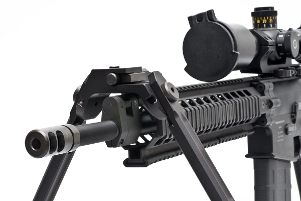

I am missing the longer upper rail so I can use a bipod something like the fortmeier, to attach above the barrel and not below.
This one looks promising but they shall eliminate that 1" empty space between the upper picatiny to barrel.
Yeah been eyeing the top mounted bipod system for a while and this upgrade definitely give the possibility of going that route. That's a different rabbit hole again! My excuse is that it can be used in my center fire rifles(that haven't seen light of day for god knows how long) also........that's my excuse and I'm sticking to it! LOL
