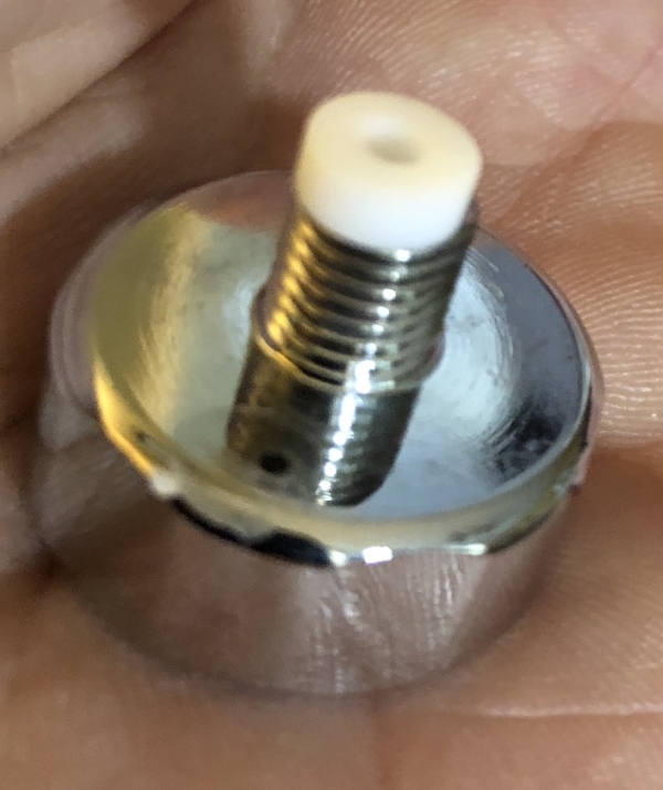

I’ve had the Nova Freedom pcp .22 for about a month now. First day I pumped it up and zeroed my scope - very accurate. After it set for about an hour I noticed the air pressure had dropped from 200bar to 150bar. I checked again an hour later and it was at 100bar. Checked for leaks at the barrel and tank - found a slight leak at the pressure gauge dial. Removed the gauge and ordered another from PCPMart. 2 weeks later it arrived with a little white washer - original had no washer behind it and dial was upside-down when tightened. New pressure gauge, with included washer installed, has the dial right-side up AND has held 200bar for 4 hours now - needle hasn’t budged. Now I’m happier that I don’t have to pump any extra for leaked air - wish they would’ve caught the missing washer during assembly.
Received my Nova Freedom .22 from American Tactical a few days ago. Noticed my air pressure dropping at a slower rate. Pumped it up to 3600 psi, next morning it was down to about 2900 psi. Later in the afternoon it was down to 2400 psi. Guess what? The pressure gauge was upside down. Removed the pressure gauge and no washer. Just for grins, I tried wrapping some teflon tape around the threads of the gauge, I'll see if that helps. If not, I'll be ordering a new gauge too.
*update - So far so good. Almost 6 hours later and the pressure is holding steady at 3000 psi.
