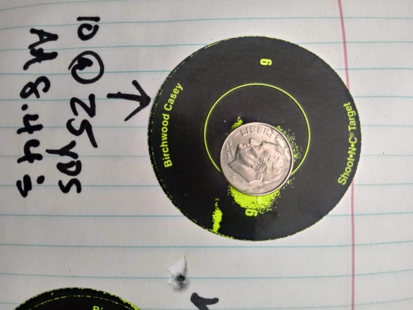

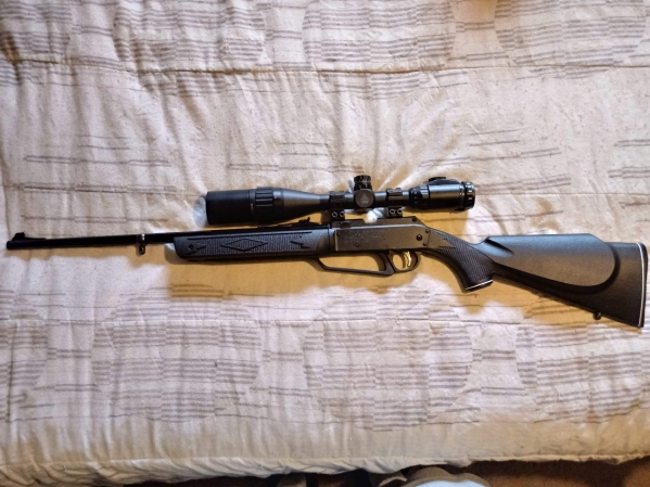

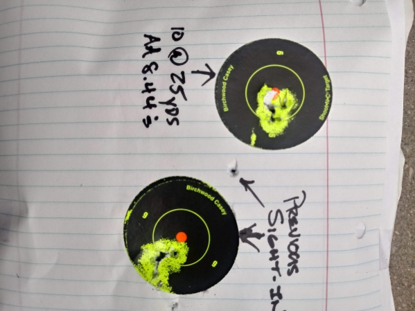

Have my 880 first pellet gun as a kid in the early 70’s to this day when it was the all metal receiver and pump handle. Call daisy couple years ago about a rebuild kit. Unfortunately they said they don’t have parts for the Metal receiver 880🙁 so I went to Wally World and bought a new 880 and took it apart to see what the difference where. What found was the new style other than the plastic receiver and pump handle was the shot tube assembly is all one piece and it has a rifled barrel unlike the metal 880 which was a smoothbore barrel. No wonder I could not hit crap with the gun accurately when I was young. So I did some grinding on the metal receiver to retrofit the new shot tube. Let me tell you I can group @30 yards with jsb 10.34 3/4 to half inch. Good enough for me. First time since owning the gun that this old 880 is a shooter. Called up daisy had them send me a shot tube to replace the one I took off the Wally World 880. Now I have 2 880 old and new that group the same with jsb 10.34. Both have the bug buster scopes on them. They are now in my collection that I take out to shoot in rotation 😎
Here's my Wal-mart special. Poured @3/4's of a tin of Crosman Piranha's in the stock for some weight (Best use I could find for them.) followed by some canned spray-in insulation to hold everything quietly in place.
Sprayed the stock/fore end with bed liner and...Presto! Also glued a little silicone bumper to the top of the butt plate so it can be sat in a corner without sliding out.
