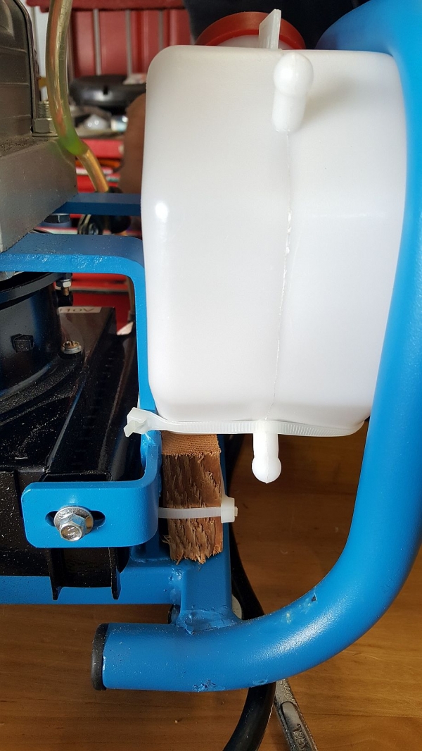

Here are some photos of how we installed it.

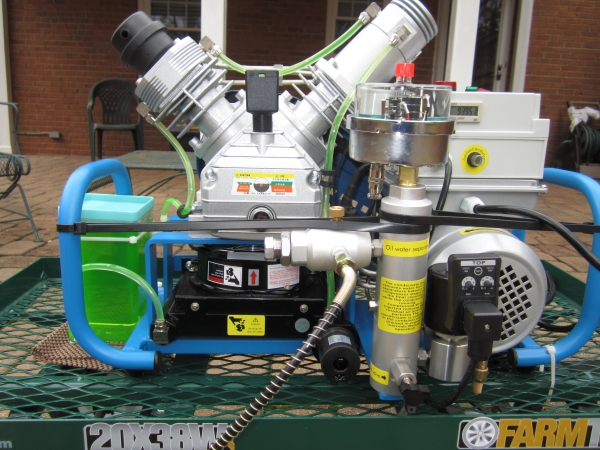

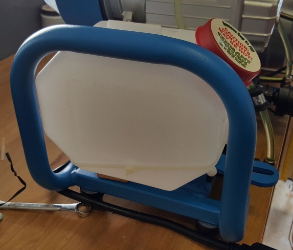

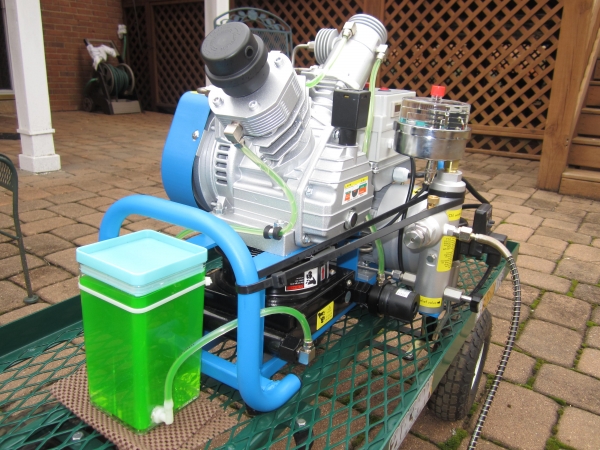

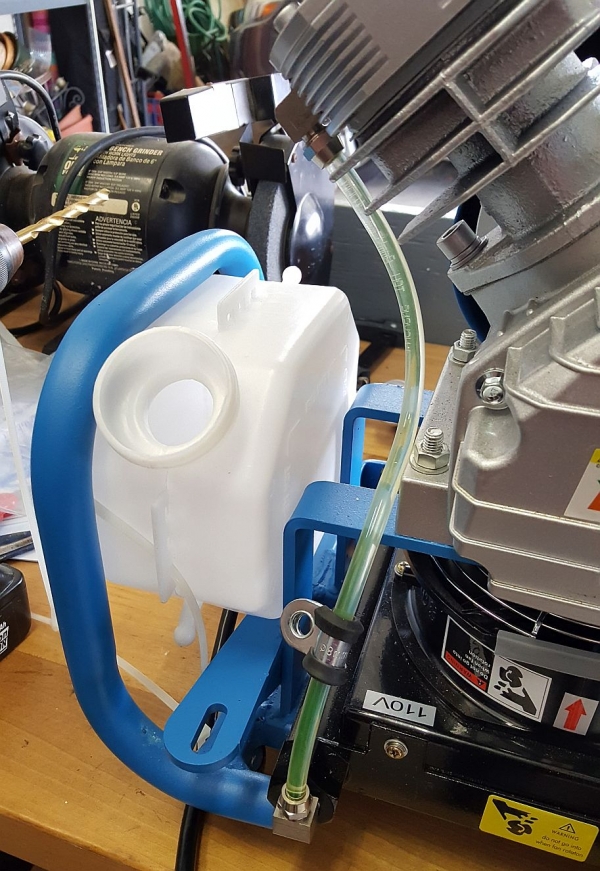

The tank was an almost perfect fit.
It needed a little support on the back, so we used a piece of wood connected by a cable tie.
We secured the tank to the frame with cable ties.

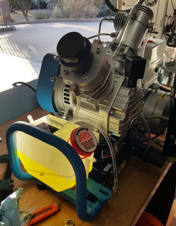

We drilled holes in the top for the input and output tubes. The tubes were inserted so that both tube ends were submerged at the bottom of the tank. This picture was taken before the compressor was started, without the added antifreeze in the tubes to prime the coolant pump.
After adding Prestone antifreeze to the tank and tubes, we started the compressor.

Initially, the antifreeze was milky from air bubbles in the system. After several minutes, the antifreeze cleared up so much that the only way to tell if it was flowing was to open the tank cap and look for fluid turbulence.
It is our understanding that a coolant recovery tank is not required. We just wanted to keep the system clear of bubbles and allow for thermal expansion if any occurs. The compressor doesn't seem to get very hot.

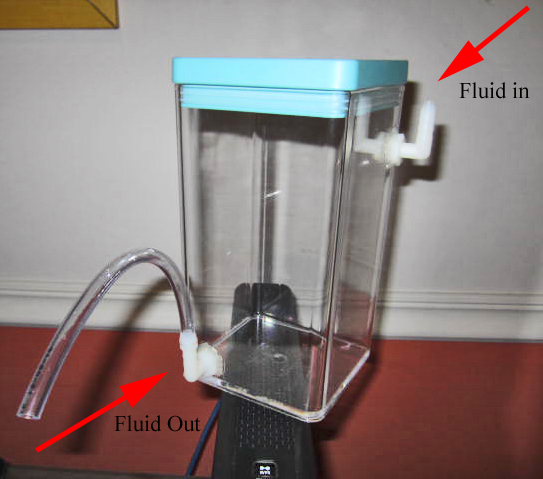

Here's another DIY coolant tank setup. It is made with 2 90 degree plastic hose barbs from the plumbing section of a home warehouse store, 3/16"ID x 5/16"OD clear tubing, epoxy resin glue, a 24" zip tie, and a one quart food storage container. Total parts cost $8. Drill holes in the container to allow the hose barbs to sit flush inside the food container. These required a 1/2" hole. The inner threaded excess was cut from the hose barbs so they snapped flush into the container sides. They are held watertight and in place with epoxy resin glue. The output tubing from the low pressure piston is attached to the high side barb into the overflow container. The tubing from the low side of the container is connected to the radiator where the low pressure piston tubing was detached. This setup uses 1/4 antifreeze and 3/4 distilled water. The ratio isn't critical unless it is stored in an unheated garage in a frigid climate.
"Humdinger"Here's another DIY coolant tank setup. It is made with 2 90 degree plastic hose barbs from the plumbing section of a home warehouse store, 3/16"ID x 5/16"OD clear tubing, epoxy resin glue, a 24" zip tie, and a one quart food storage container. Total parts cost $8. Drill holes in the container to allow the hose barbs to sit flush inside the food container. These required a 1/2" hole. The inner threaded excess was cut from the hose barbs so they snapped flush into the container sides. They are held watertight and in place with epoxy resin glue. The output tubing from the low pressure piston is attached to the high side barb into the overflow container. The tubing from the low side of the container is connected to the radiator where the low pressure piston tubing was detached. This setup uses 1/4 antifreeze and 3/4 distilled water. The ratio isn't critical unless it is stored in an unheated garage in a frigid climate. ....... nice Steve, where did you get the container ? roger
