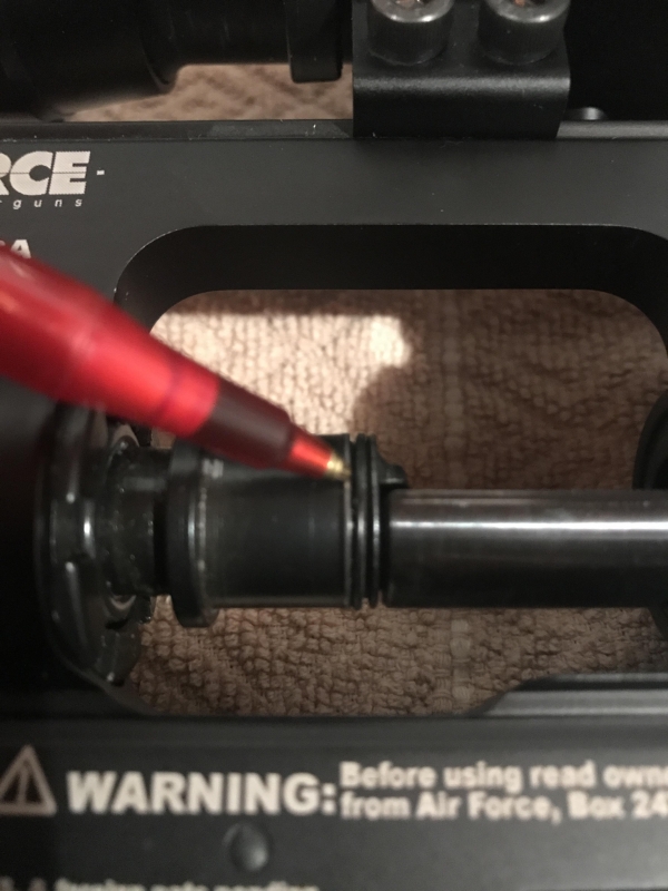

Hi Travis, just saw this. Took a pic of my Texan showing the breach seal. I wish I could tell you the o-ring size, but as you can see it’s a very THIN diameter. #1 suspect in your missing foot poundage case, haha.

Here's a pic my brother sent me today.

But as to my brother's gun, the oring is likely the primary problem.
