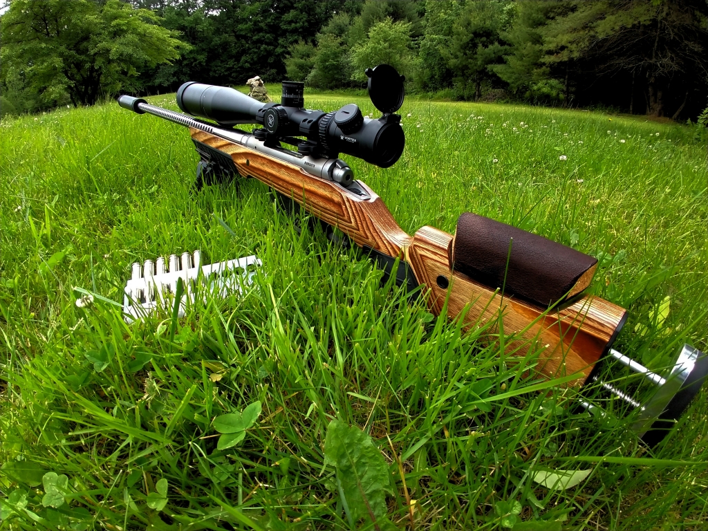

Then you start getting into "real man's" calibers, like 7mm Rem Mag:
Now we're into 3,000 foot pounds, and we're not into the realm of true big bore high power rifles, it can still be run on your basic "universal" centerfire rifle suppressor. (in this case a Silencerco Omega pictured)
