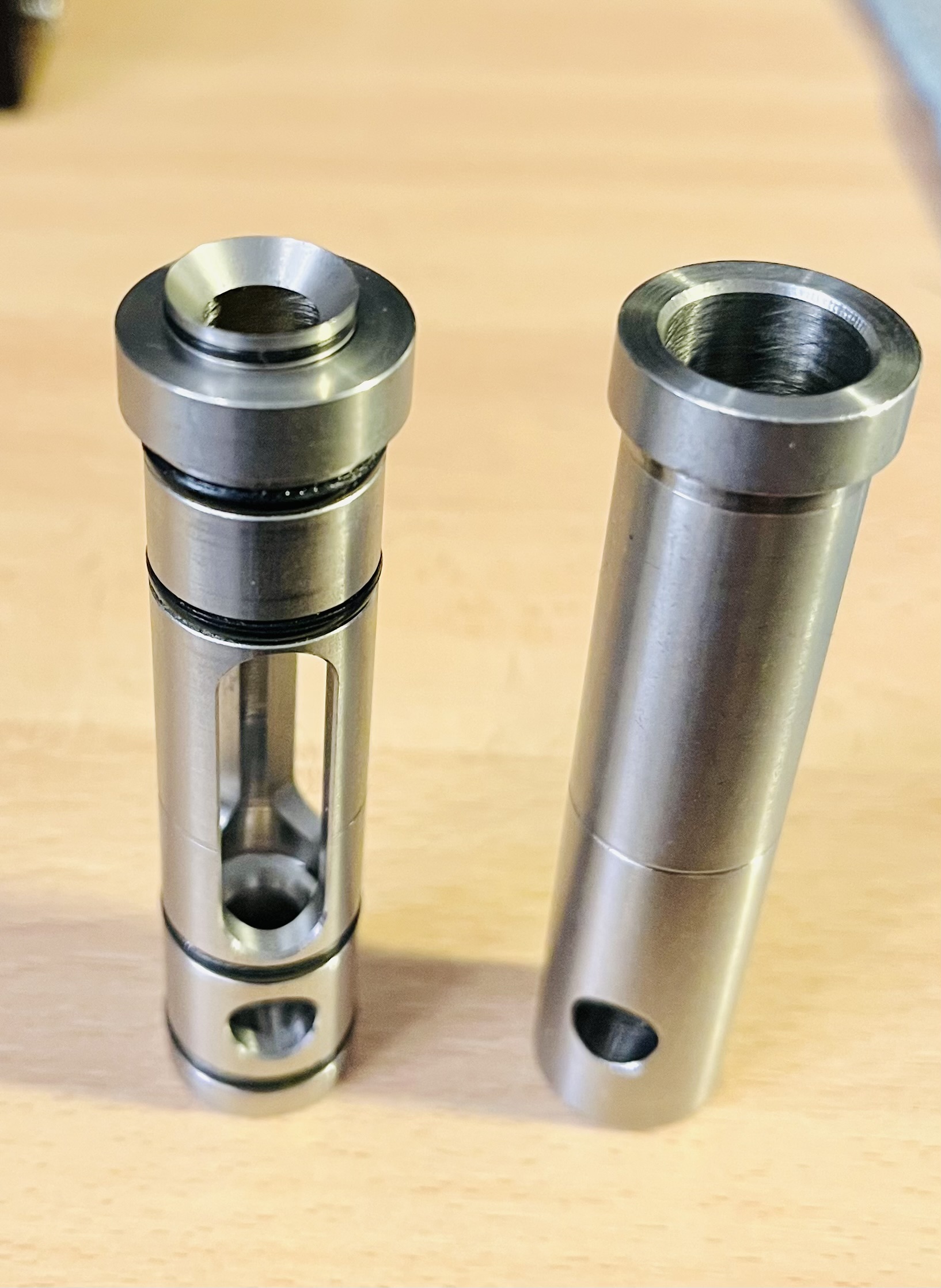

I have installed a powerblock on an M3.The M3 kit is reduced in the number of parts that compose it. I have to mount a new Valvehouse, Impact, Power Plenum part number fx 20671 in which the valve seat is included with a used part which is the valve part number fx 20275. The problem that causes me that combination of used part with new part is a small air leak, my intention is to rectify the valve and seat with the same technique that is used in the valves of the engines but before I would like to know your opinion or your experiences.

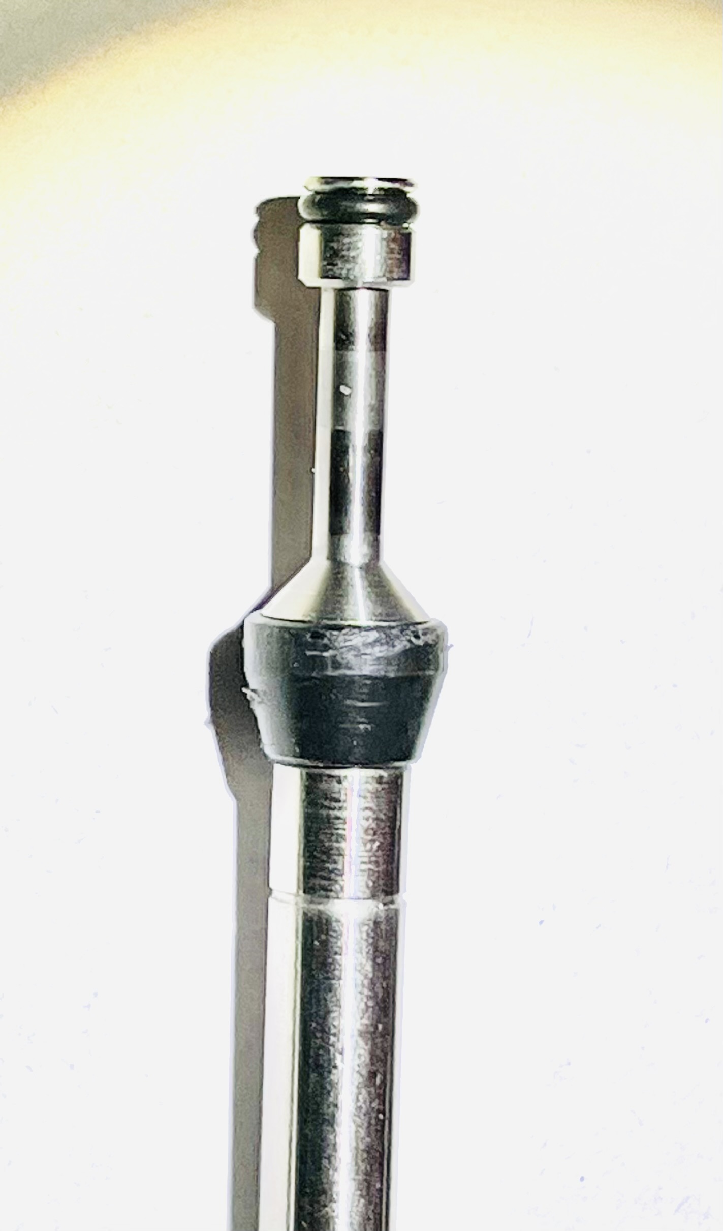

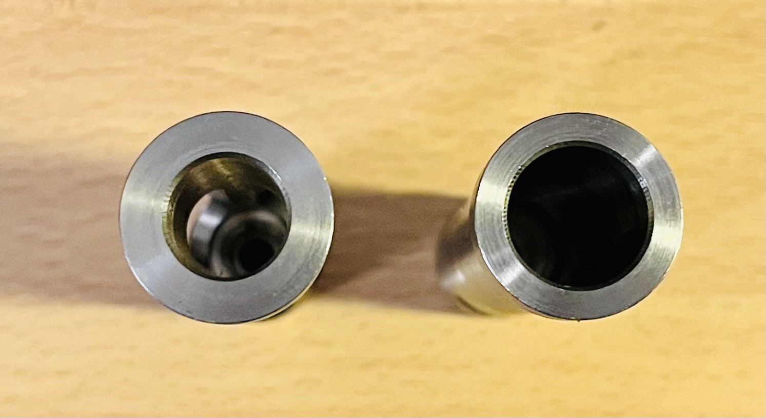

I wonder if you have the old 20275, they increased the size of the poppet to help with these leaks, I bet I could tell if you have a picture.

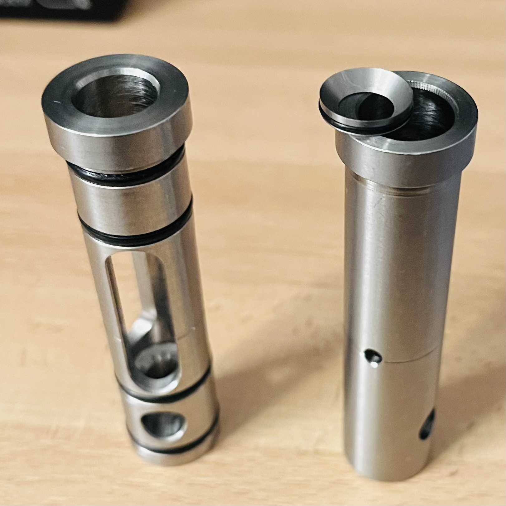

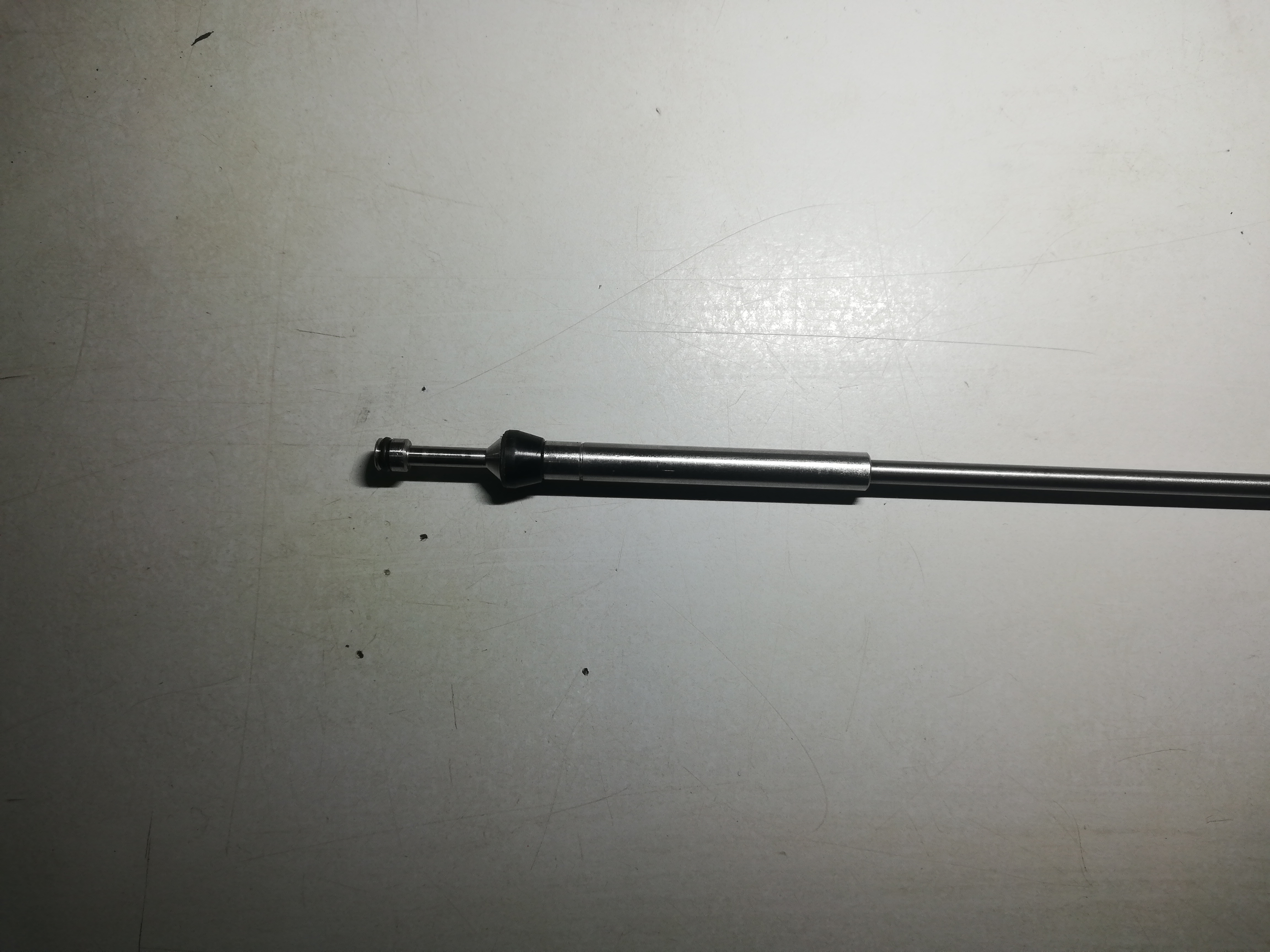

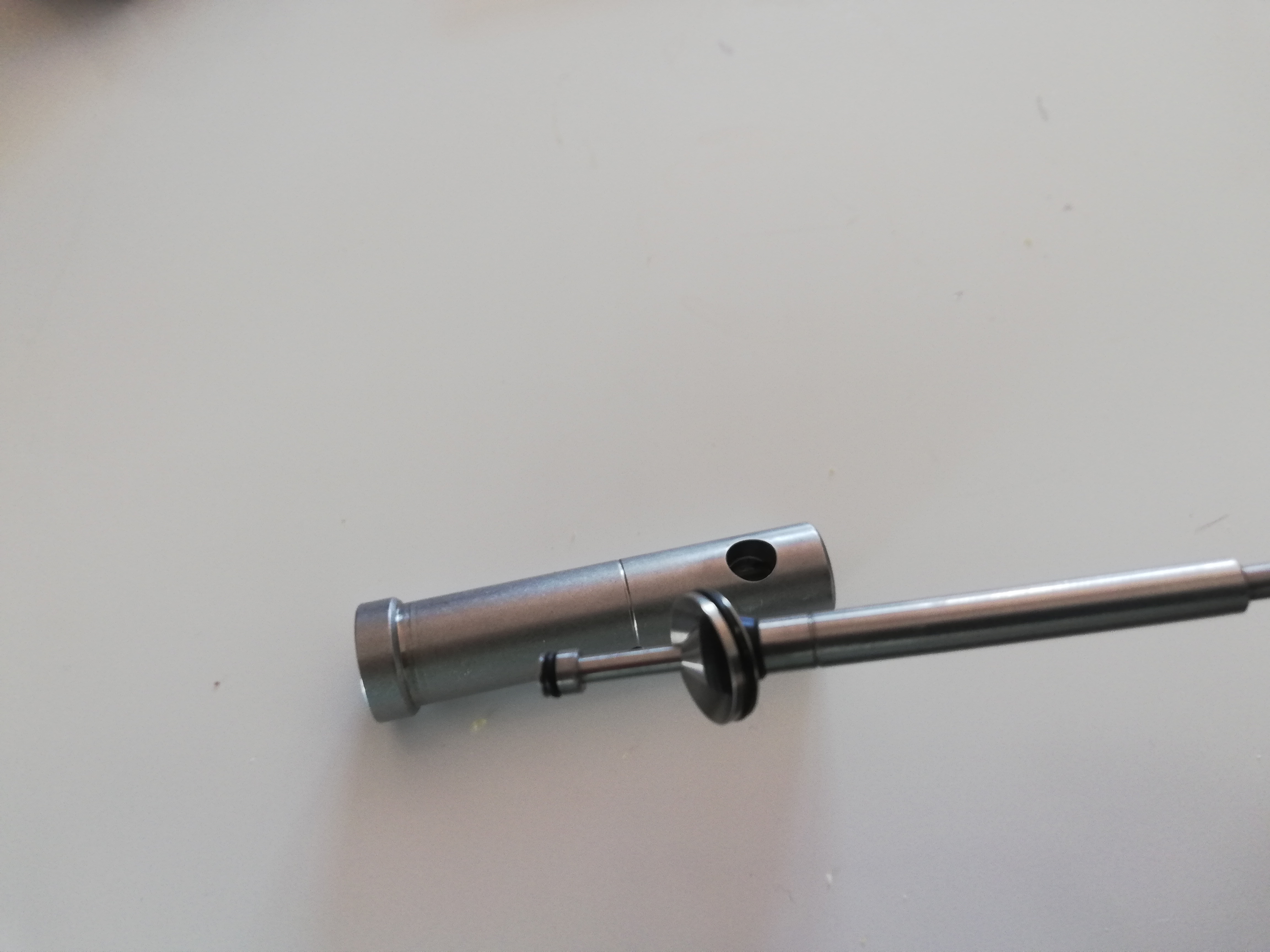

I finally disassembled my M3 and found the mystery of the air leak.

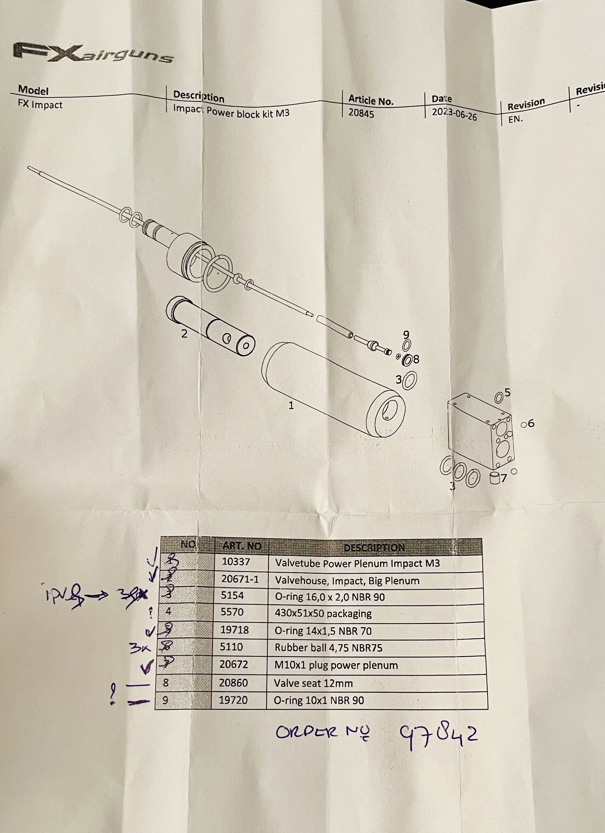

Do any of you know the difference between these powerblock kits?
Fx 20845 and Fx 20825

The kit looks right, they started putting removable valve seats back into the plenum house and increased the poppet size.. Your kit looks like the updated parts.
If I buy a powerblock M3 kit and they have modified the valve seat size it should come with the valve corresponding to that modified seat.
These are my thoughts, Now I have two problems
Hi guys

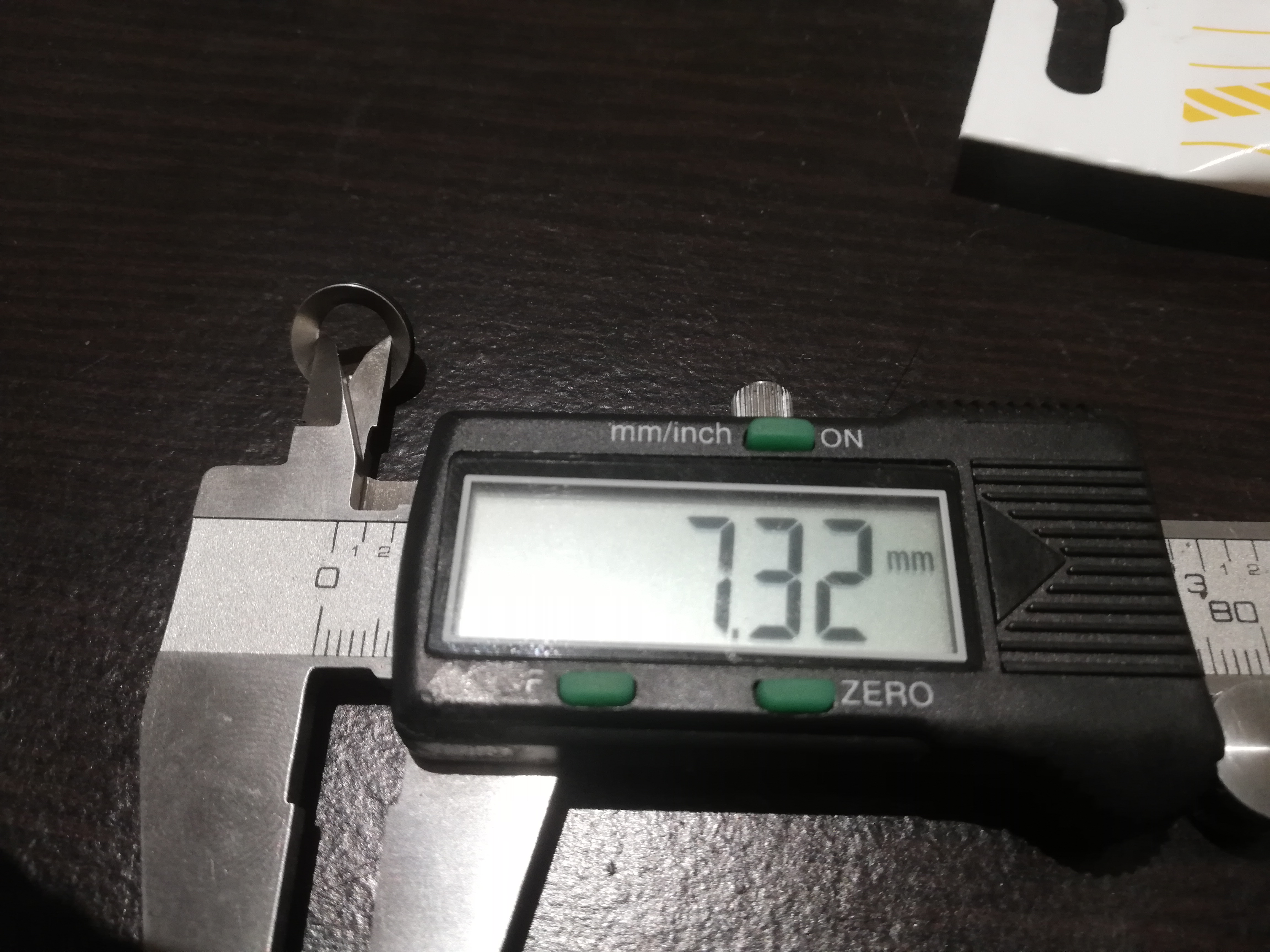

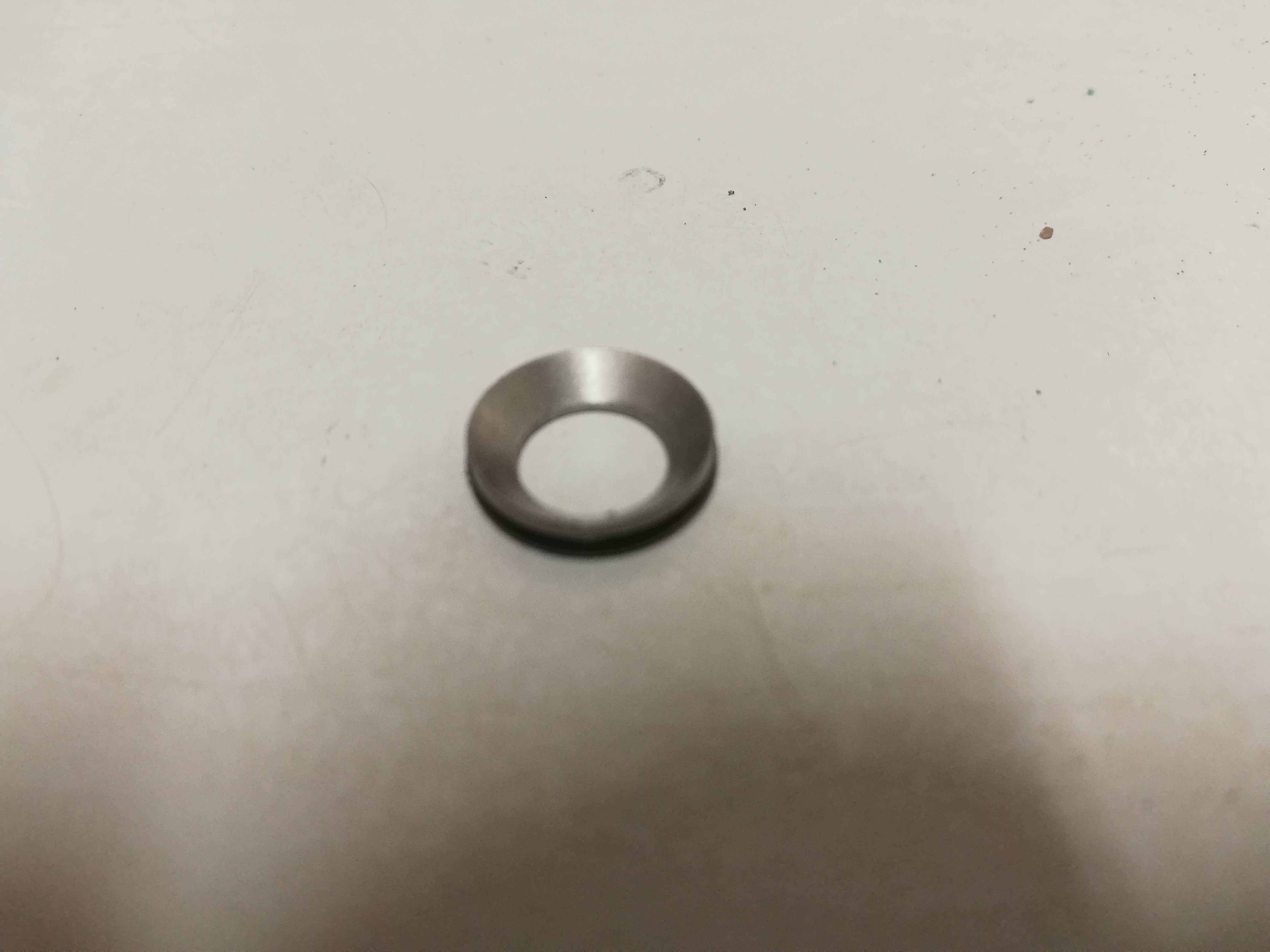

Fx has modified the valve seats on the M3 powerblock to be removable and larger diameter Fx 20671-1 and the valve is also larger diamerter Fx20860.
The valve fx 20860 is not included in the kit for M3, must be purchased separately
If you bought the new powerblock kit for M3 and you have an air leak through the barrel you need to buy the new valve as well.
