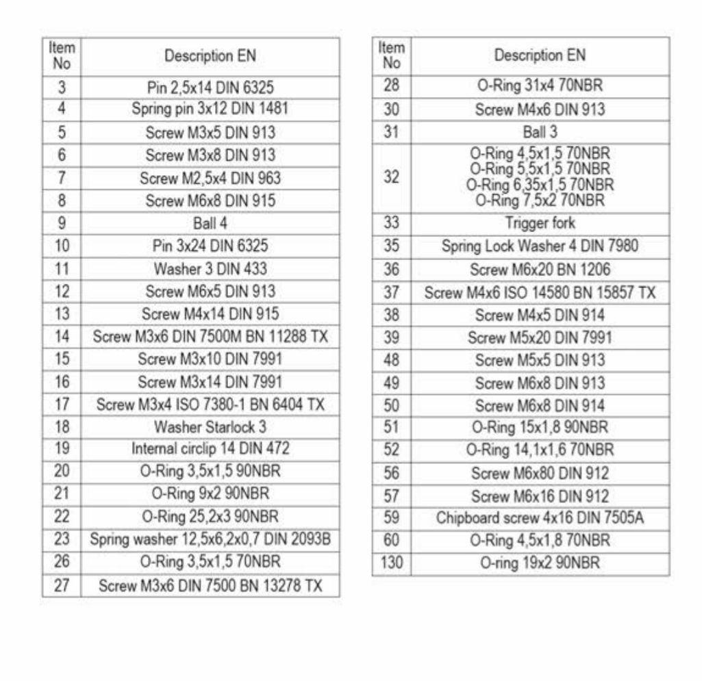

Hi all,
I'll be playing with a regulator pressure a bit, can't get 25 grain slugs to fly consistently faster than 940 FPS and reports have it that those are most accurate between 960 and 980, some well over a 1000
To change the regulator pressure whole thing has to be disassembled since reg is not externally adjustable.
Disassembly and reassembly can lead to damaged o-rings
Is there a list of o-rings for Vulcan 3 in .22 anywhere to be found?
Does anyone have at least a partial list? Cylinder/plenum/regulator assembly preferably
What size is the o-ring inside the barrel just in front of the transfer port? I stock spare breech seal o-rings for every air rifle I have and for this one I don't know the size
I know there are complete sets to buy but for that price I can buy o-rings for 10 whole sets only if I new sizes needed
Thank you!

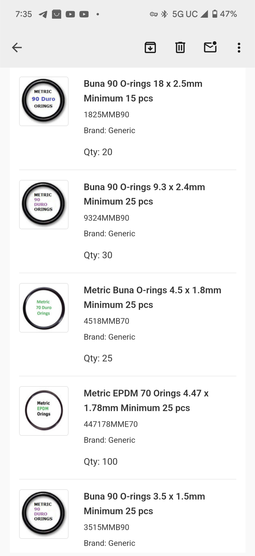

I believe the manual shows which o rings are which, otherwise I have seen some gun schematics off if AGT's website. Also Talon tunes sells the o ring kits.
The o-rings in the V3 are very tough. I've had mine apart a dozen times without o-ring damage.
