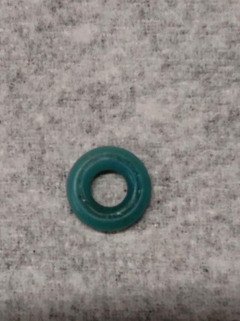

Mine is a .30 and when the C3 went bad, it lost over 100 FPS.
It looked like this:
