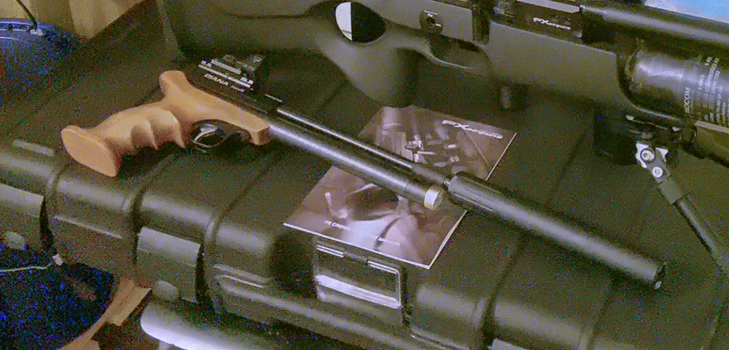

This one is a 17 cal. regulated, and internals have been changed to smaller dimensions. (more air capacity) 50 shot count at 630fps. I like it so much, I've got a 25 cal pp800 on the way 👍
