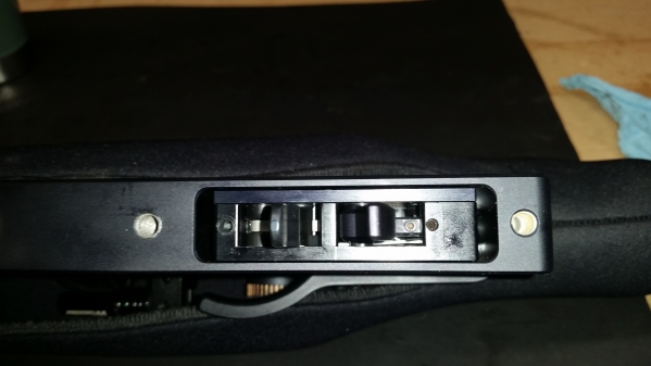

I would just do it in the receiver. I edited my last post with a couple items. I have never adjusted mine. It is perfect the way it was set. If you don't feel comfortable ask Martin to do an exchange on trigger assemblies. I'm sure he would work something out for ya.
Oh, OK; so the pins stay in, the trigger assembly stays in the receiver, and the rifle is simply cocked normally, right? Thanks for that picture; very helpful :). The trigger came from Minor Hill set at only 4.7 oz with no first or second stage travel. I definitely do not feel comfortable with such a hair trigger.
