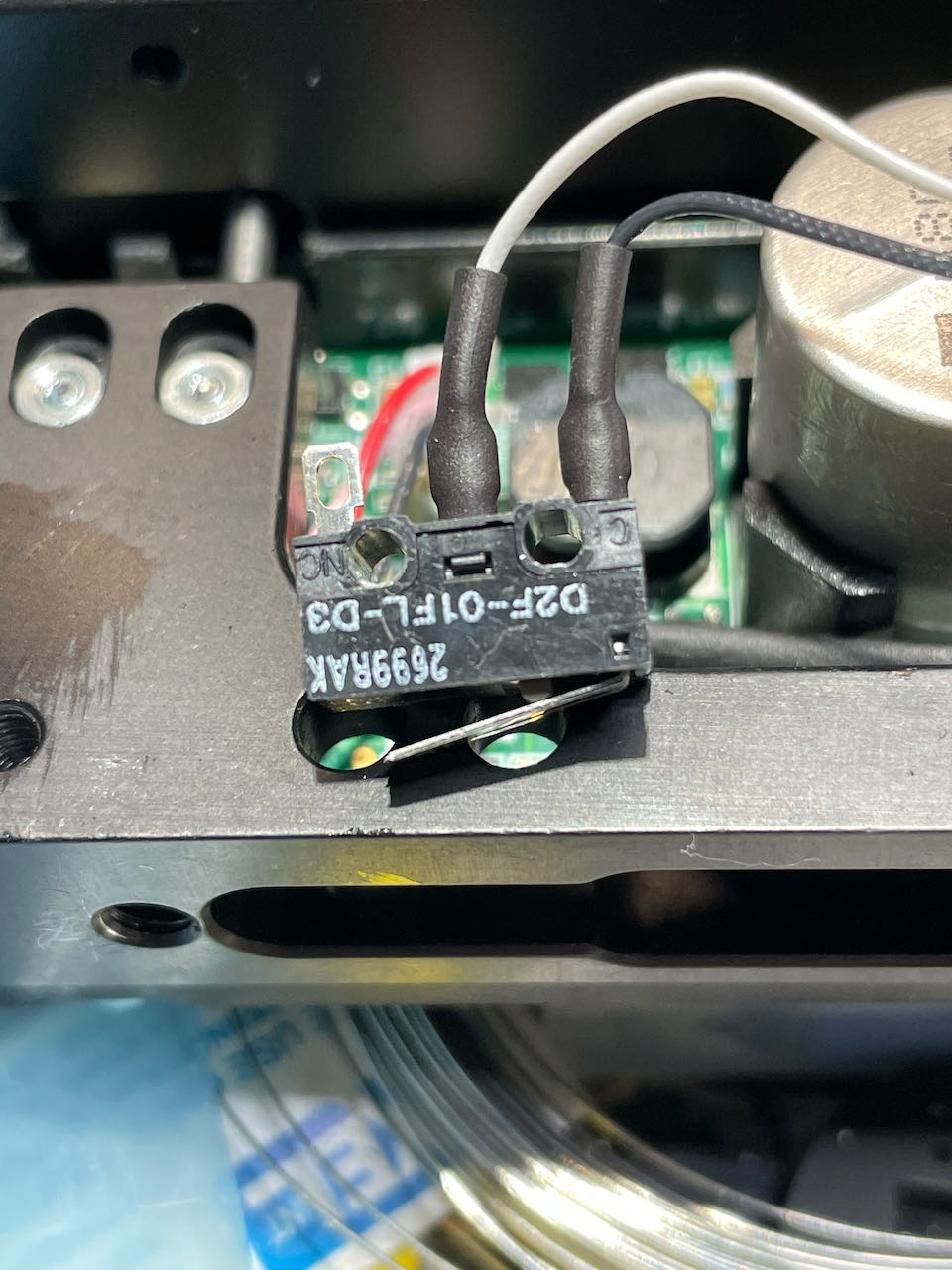

It's actually much easier than the pulsar - you just remove the trigger guard which houses the trigger and first stage spring - don't lose it and the very small brass washer that sits on top of the first stage weight adjustment grub screw. Then you remove the two M2 screws locating the limit switch, carefully slide the switch up and out, carefully cut the heat shrink to expose the solder and desolder the two leads to the limit switch -then reverse the process with the new switch. Daystate trimmed a couple of millimeters off the the limit switch contact so that it won't interfere with the trigger guard - this can be done with some good fine wire cutters. The limit switch with double the actuating force makes a huge difference - like clicking a good mouse button. You can purchase this switch from Digikey for a couple dollars.

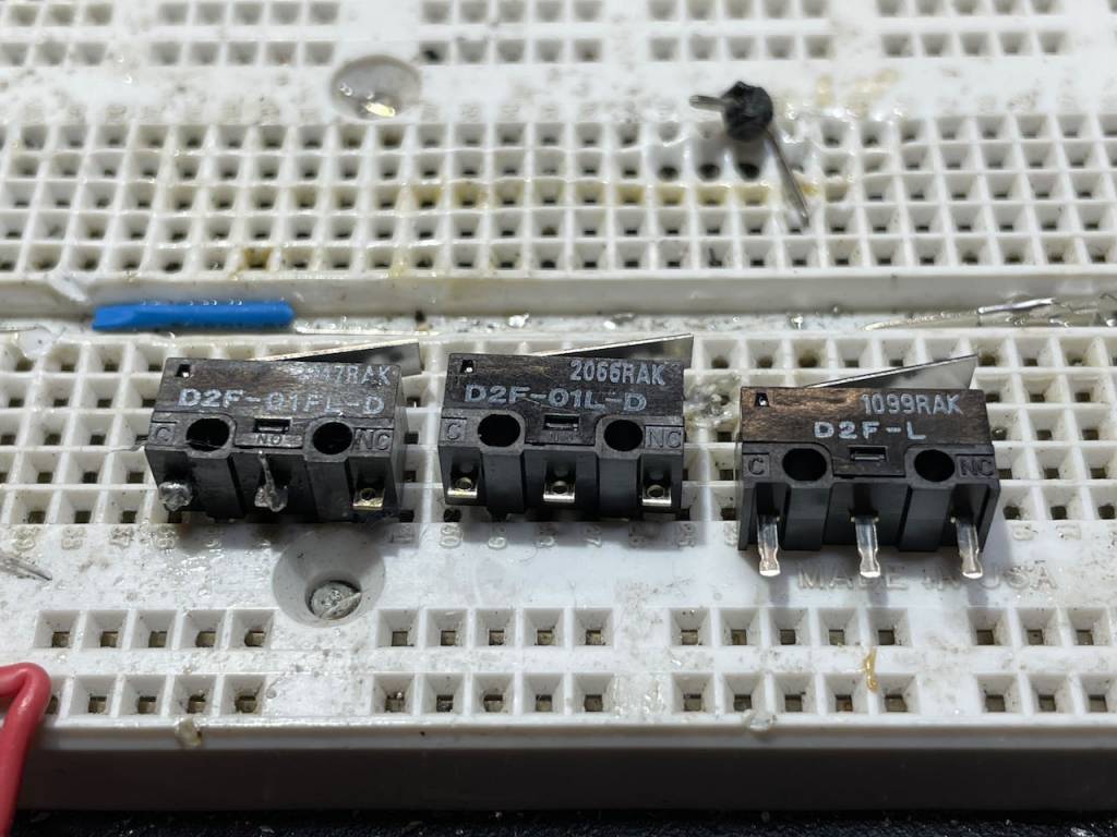

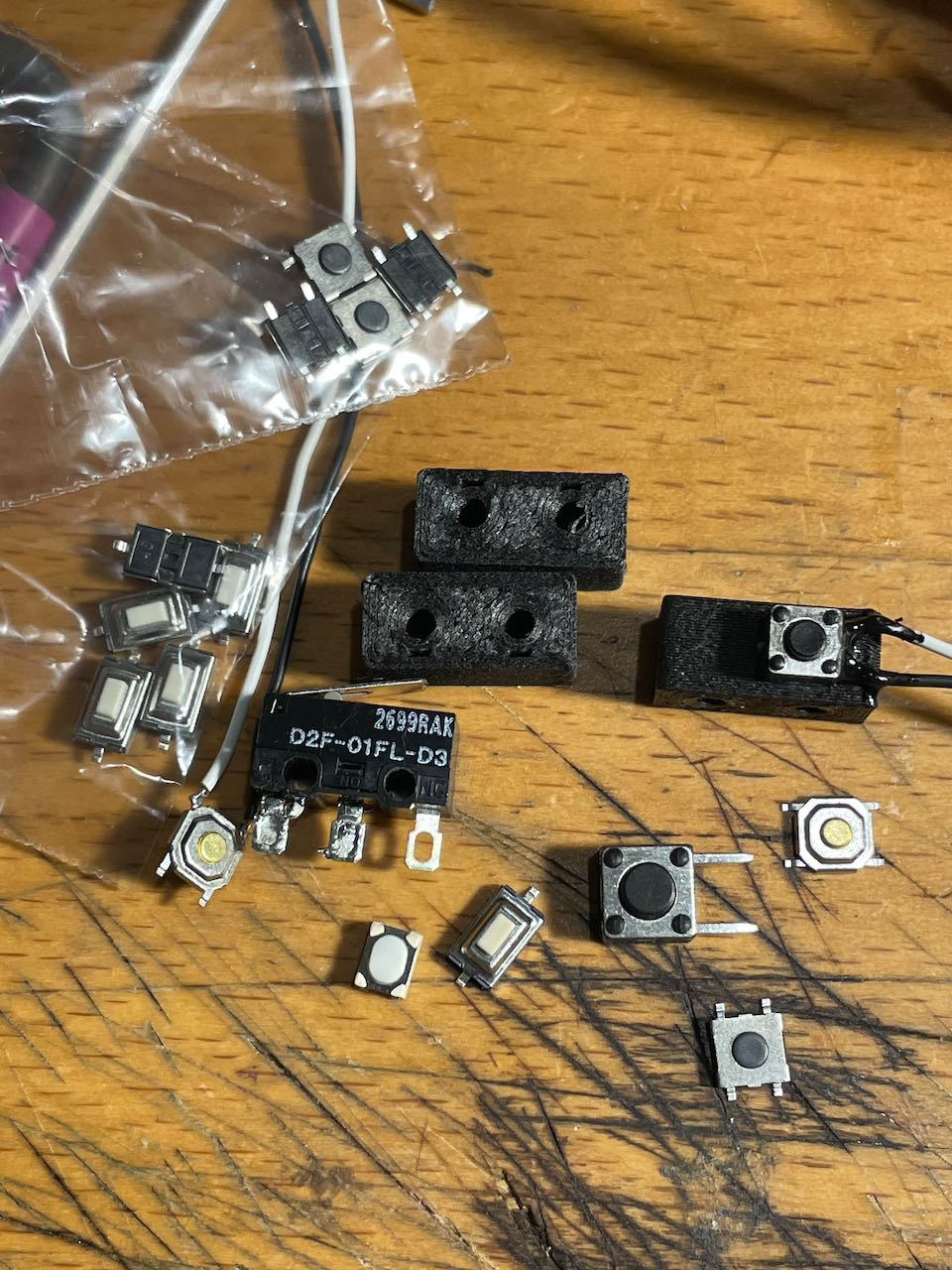

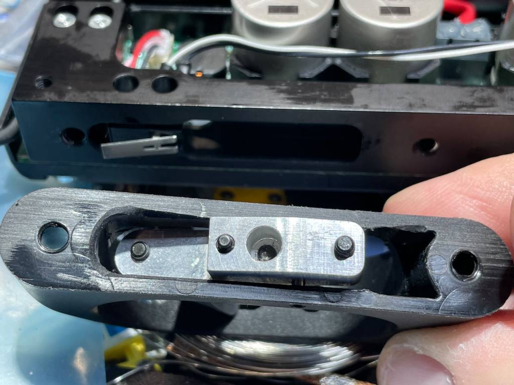

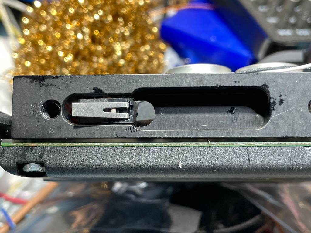

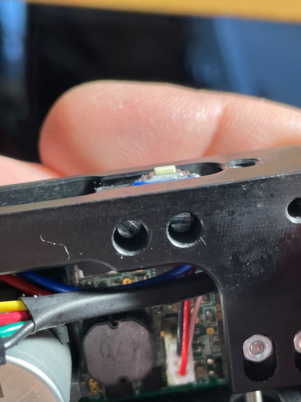

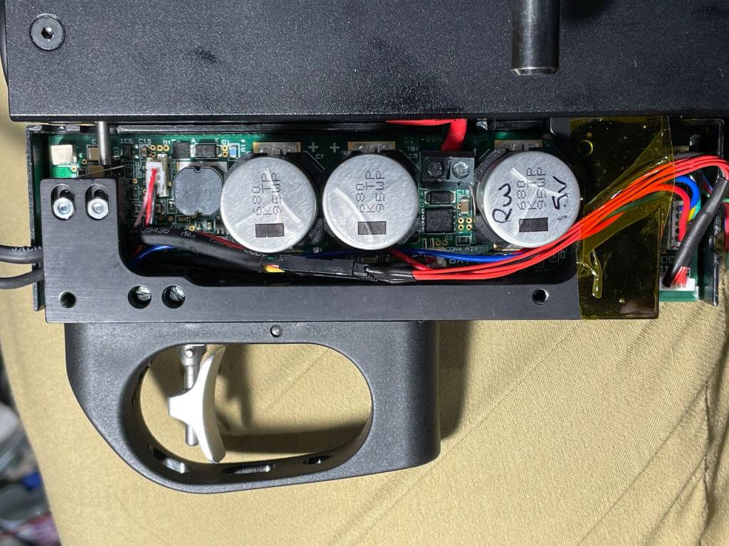

So.... I went full mod on the Red Wolf trigger and came up with something very nice - I replaced the limit switch made to count cans of soda as they drop out of a machine to something designed as a human interface - the ubiquitous "tactile switch." There are are enumerable types of these little clicky switches in everything that has push buttons. I 3D printed a mounting base for the switch that I liked the feel of the most and mounted it up in the Red Wolf. The result is an amazing improvement over the factory limit switch which BTW is the same one used for the safety catch. No creep, very predictable and a significantly heavier than the factory which is not adjustable in any way - not sure why they tease people with a second stage adjustment screw. Here are some pics of various switches I played with and the final mod:

I had a brief discussion with John and asked if he’d be willing to help with an improved trigger for my new Red Wolf Safari. I had hoped the Red Wolf trigger would be improved over the Air Wolf - unfortunately, it’s not.
John was more than helpful, he actually built two triggers like the ones above, on his dime, to test in the Red Wolf. Incredibly nice of him and an incredible improvement.
With both my Air Wolf & Red Wolf I had dialed out all of the 1st stage since the transition from 1st to 2nd was so imperceptible it would often unintentionally fire. John’s improved trigger is just right; not to light and not to firm with a much improved break when fired.
