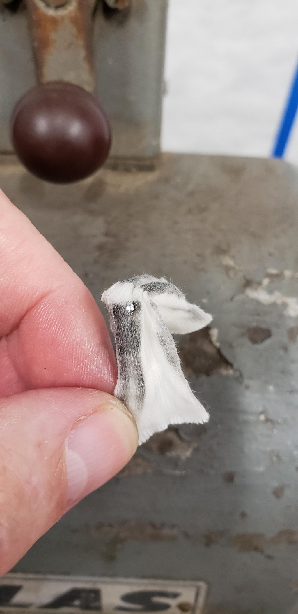

I will say this, don’t panic! and do something that may void your warranty... first of all,”if you listen to fx proponents fx barrels are the smoothest of all known to mankind”, 2nd contact dealer where purchased see if they can replace liner or give advise! 3rd make sure what your seeing is actually chips of lead because it can appear this way in most barrels!,if I pull a clean “DRY” patch threw my 4 LW poly barrels it can appear this way also! 3-of these LW’s have been inspected a broken in by Martin Rutterford of RAW! and all of these barrels SHOOT!

This is a patch after 63 rounds. That little shiny spec is a flake of lead.
I polished the barrel with JB last night. I'm going to try it out again tonight. I'll also try lubing the pellets.

I always polish my barrels. It has never once hurt accuracy. Doesn't always improve accuracy, but makes cleaning much easier. When they'd get as bad as yours was getting....id get after them with a brass brush. Had a wildcat that would get that way. A polishing took care of that. If you need to hit it one more time, do so.
Edit:
Just a thought... It's hard to get the lead out with just pull throughs when it gets as bad as your barrel was. A few passes with a brush wouldn't hurt. You may be surprised that there was some still hanging out in there and polished over it.

I've contacted Pyramyd Air for help. They can't send me a new liner, but they will take the gun back. I hate to do that, just to replace the liner. I have contacted FX service. I think they might be closed today. They are also closed July 12th through 28th for summer vacation. I hope they can resolve this before then.
I do have a chronograph. The gun is very consistent. I haven't recorded the shot strings, but they are well within 5 to 10 fps. I have tried JSB 10.34 at 900 fps, JSB 8.44 at 907 fps, H&N FTT at 905 fps, and CPL at 910 fps. All had similar results. I also tried lubricating the pellets.
I really like the ergonomics, fit and finish of the gun. If I can't get a new FX liner in a reasonable time, I may just buy and fit a Lothar Walther barrel to it. The way the Crown mounts the barrel, it would be a very easy installation.
