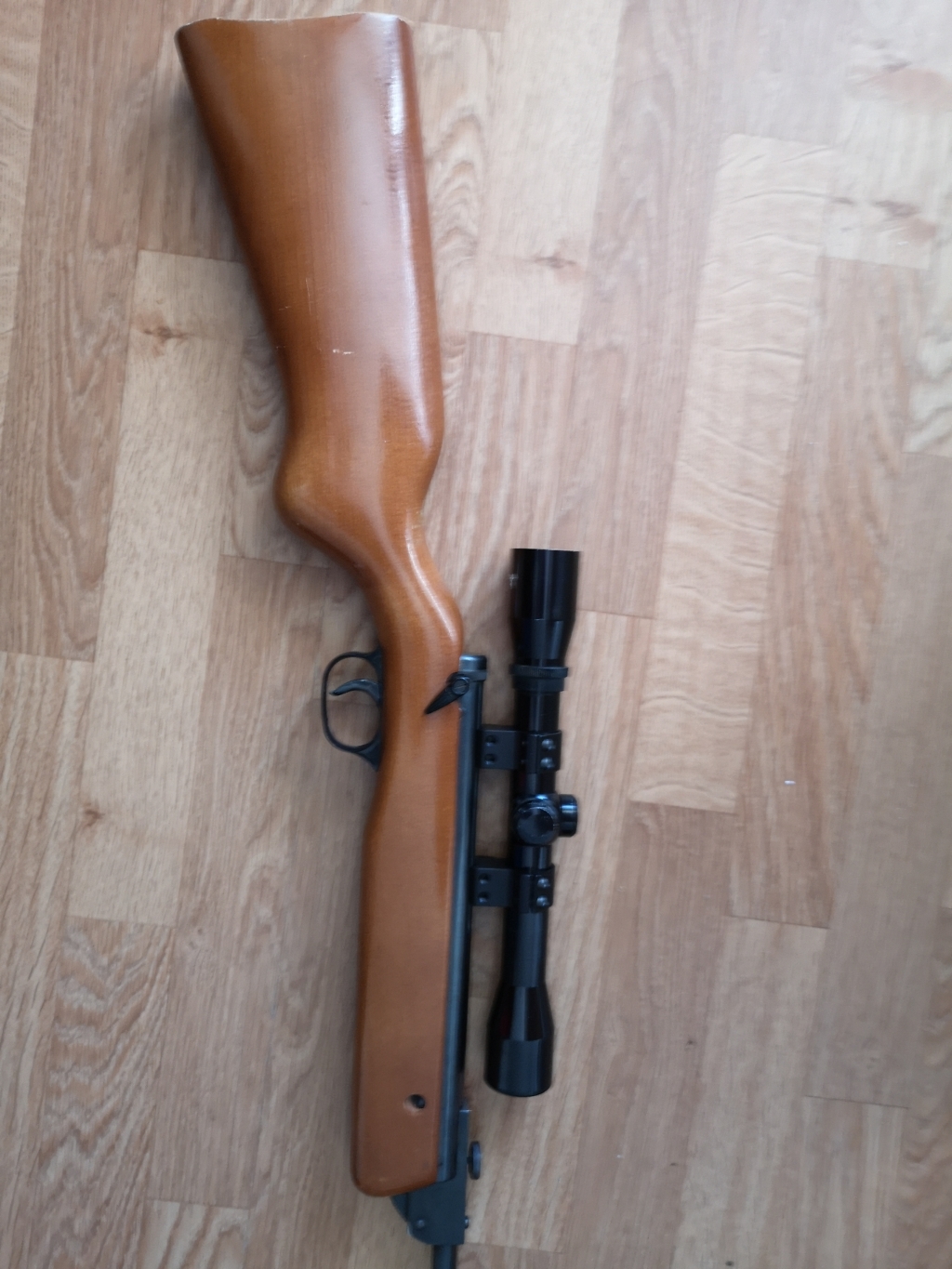

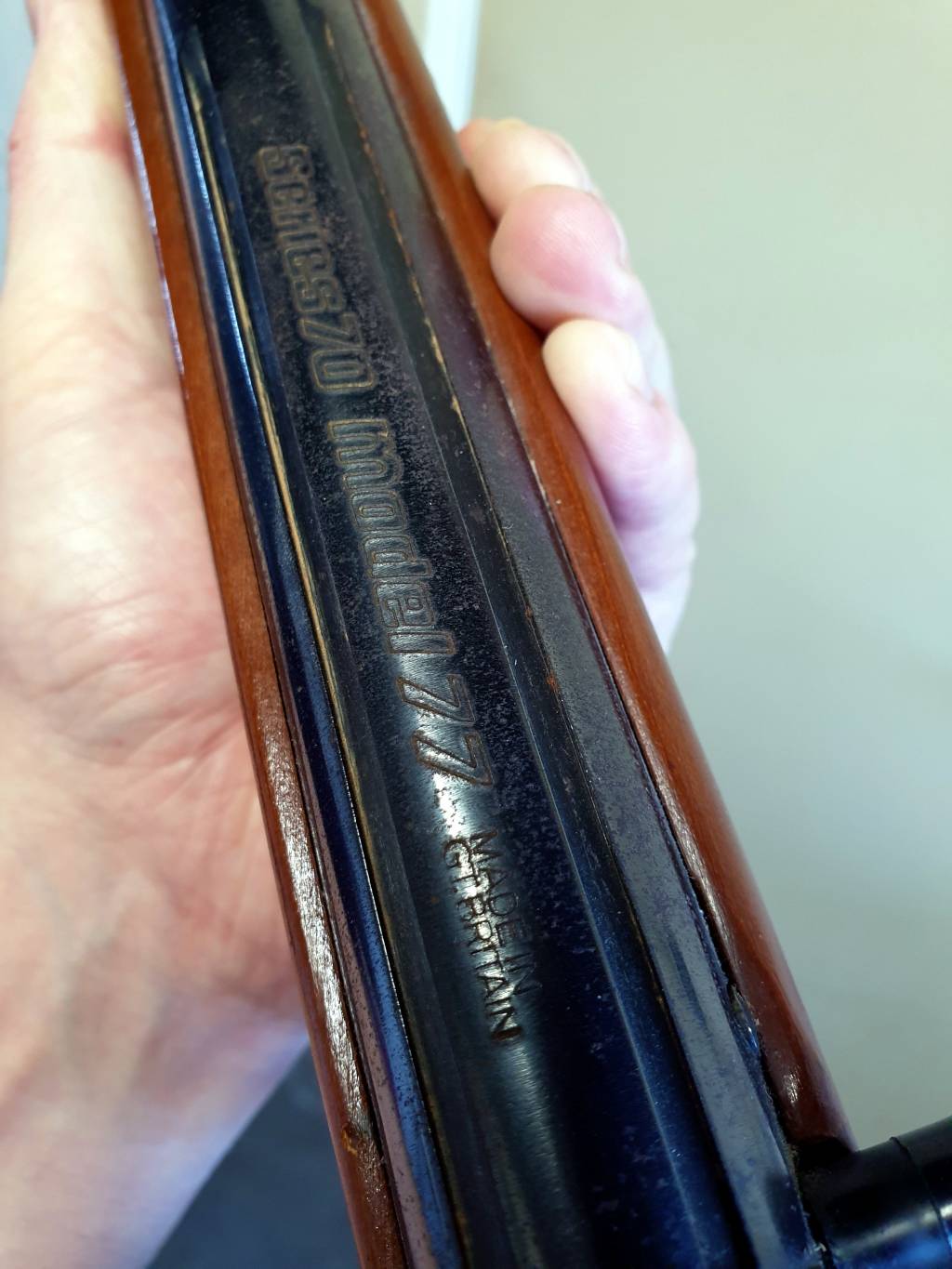

Bought an old airgun at an online auction without even now what it was, it's named Milbro 70 series modell 77 .177,it can also be found as a Diana modell 77, as far as I have read milbro bought some or all of Diana after ww2 and then Diana bought it back in 1984, i have not found so much info about this modell, only that it's a low power so so gun that isn't worth much, well i can agree that it's low in power, but that is not always a bad thing, cause this gun is very smooth, it reminds of a hw30s in the feeling, but one size bigger, unfortunitly it didn't have any open sights but i had a scope that works ok, the power is around 4 1/2-5 ft/lbs or 6 joule, i have only tried it at home shooting at 3m, need to do some pellet testing to see but jsb 7.33gr, 7.87gr and 8.44gr 4.52 headsize shoot very even over the chrony. If you now anything about this modell please write some info!

Those guns have quite an interesting history.
After WW2, Milbro (full name Millard Brothers, located in Lanarkshire, Scotland) purchased the pre-war airgun production machinery and many parts from the Diana factory in Germany, them set up production in Scotland. Starting in the late 40’s they initially made straight copies of the pre-war German models. Later on the guns were modified with different stocks, triggers, sights, etc., but retained the basic “architecture” of the old German models. There were “Series 70” and later “Series 80” models.
Most Milbro rifles were based on the Diana 25 youth rifle or slightly larger model 27. I believe the Series 70 model 77 was one of the latter. Very nice all-round light rifles, as you note in the same general category as the R7, etc. They do have leather piston seals which will last until doomsday if you take care of them. The breech seal may be leather but can usually be replaced with a rubber O-ring and maybe a little shimming.
Milbro went out of business in 1980 or so. Up until that time they had rights to the “Diana” name in the UK. Post-war German rifles sold there in those years used the brand name “Original” (as in, hey fella, this here is your real original Diana, LOL).

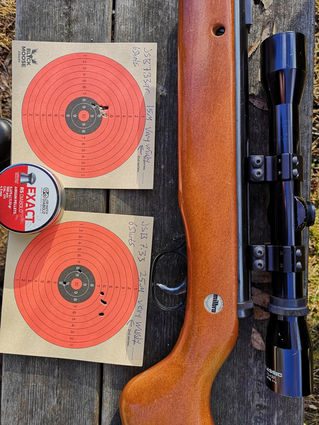

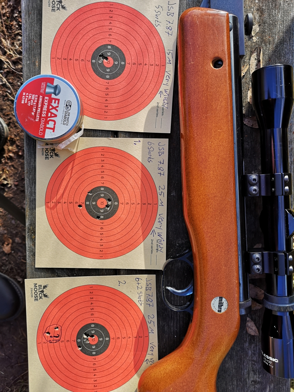

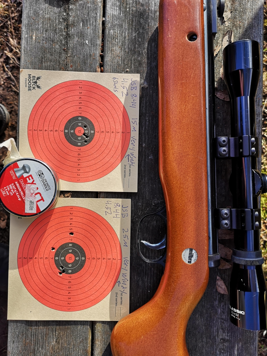

Thanks for the info MDriskill, yes this modell is very nice to handle, did my first shots at targets today at 15 and 25 meters, wind was horribel with very strong gusts, so bad that the papertarget flew out of the holder... But i managed to get some great result with jsb 7.87gr, the pellets i used was jsb 7.33gr, jsb 7.87gr and jsb 8.44gr 4.52 size, at 15 meters the tightest group was with the 7.87gr, at 25m they spread out a bit so i adjusted the scope 2 clicks up and shot another and got a very nice group but 2 of them dropped realy low, don't know if the pellets where bad or if the wind did it or what, the rest of the ones i shot was with the others in the middle, the trigger is fantastic, i think Diana is the reason for that, very happy with this gun!

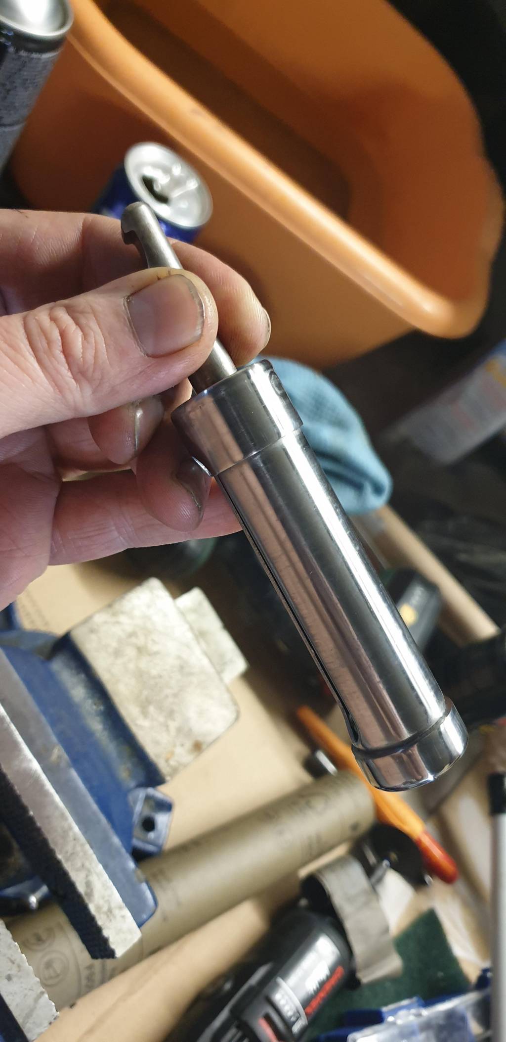

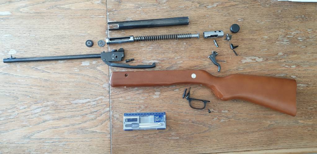

I's my dad's. It was left for decades and I picked it up this year. Replaced the broken leather seal and the breech seal, cleaned everything, polished the piston, new spring, sanded and polished the metal, reblued it quite succesfull.

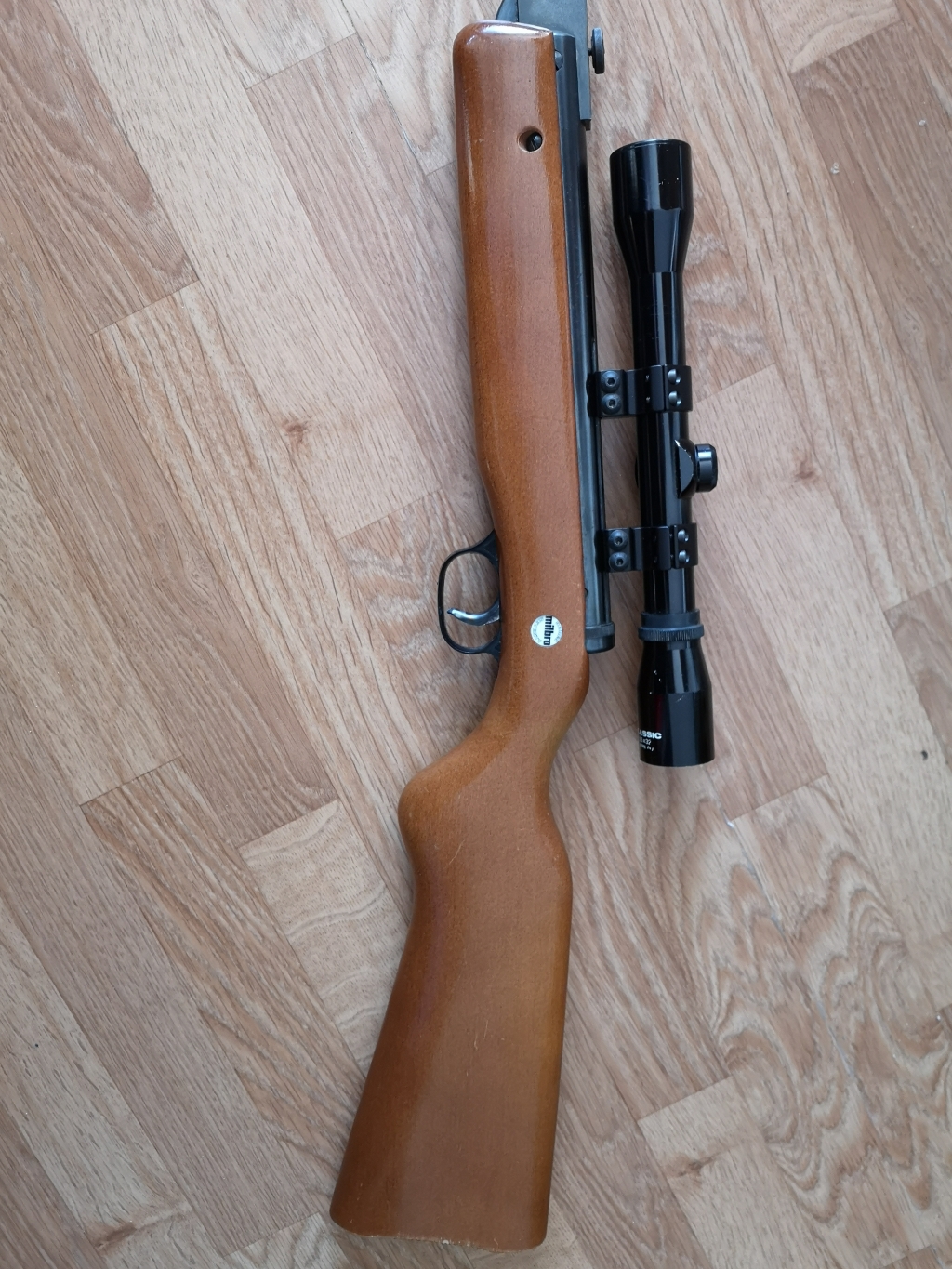

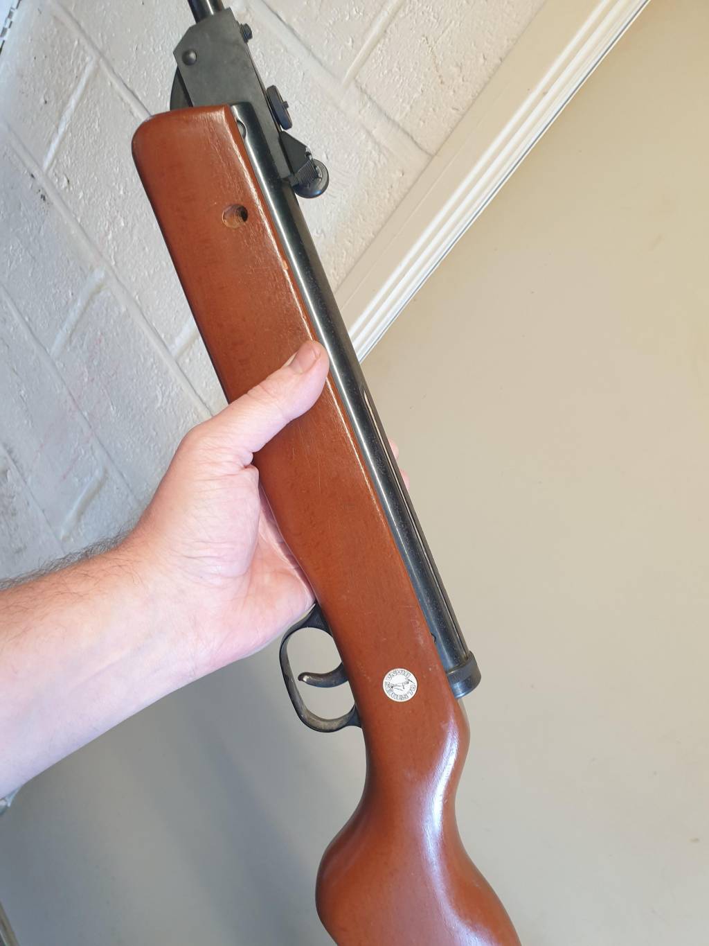

Ironically, my rear sight is not missing but the windage wheel broken of. Since I couldn't find a replacement (boy I looked!) I glued it, so no more windage :)
Mounted a scope on it and it shoot very accurate at short distances (10-25m) with some practice!
Pre-restauration:
 (windage wheel still on but bent and stuck, broke the screwing pin part later...)
Post restauration
Thx! It was a first experience for me, but watched TONS of youtube video's :)
