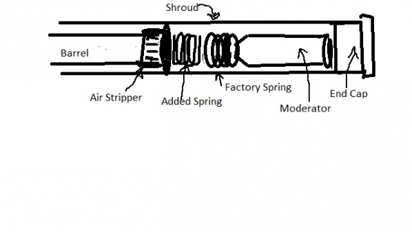

Umarex installs a spring between the air stripper at the end of the barrel and the so called moderator they have. I suspect that spring is to lock the barrel and shroud together and possibly control barrel harmonics a little.
I found a one inch spring in my collection box that is the same diameter of the Umarex spring and somewhat stiffer and added it in series to the Umarex spring. This considerably stiffened up the connection between the barrel and the shroud. It seemed to lock them in place much tighter and I can even pick the gun up by the barrel without shifting the POI. I do avoid doing that though.
Now the gun much more reliable and I am back to numerous one hole groups at my 40 yard range.
If anyone is suffering POI conditions with their Gauntlet, maybe doing something like this may help. Sorry I can't give specs on the spring I used, it was just one I had hanging around.

Actually, making a hard connection between the barrel and shroud then using the force generated by the springs to keep things in line and eliminate barrel / shroud vibration was the concept. There is a lot of leverage at the end of the shroud and only a small area with two small grub screws holding the barrel tight to the breech. That set up needs all the help it can get. It seems a good number of PCP's face this challenge.

Sorry no pix taken on this one. It was a frankenfiffer experiment that seems to work. Just get about a one inch spring that is the same diameter as the factory one and put it in with the factory spring. The idea is to add a larger force between the barrel and shroud

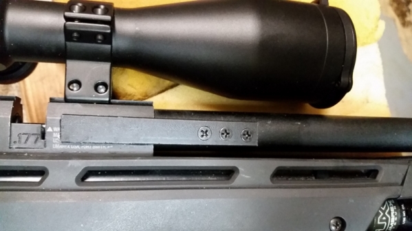

I went one step further to stifffen up the shroud weeks before adding the spring. It helped but didn't stop the POI shift completely. I was thinking of smacking the gun against a tree for a while there, but that was when the spring idea popped in. Not caring about the warranty, I roughed up the sides of the breech and fabricated two flat steel pieces. Then JB Welded them to the sides, drilled and tapped 6 screws into the shroud, 3 on each side. It ain't pretty, but it is better than the tree idea.
If the gun holds the line and continues to be accurate as it has been since springing it, with no more shift, the tree gets to live.
