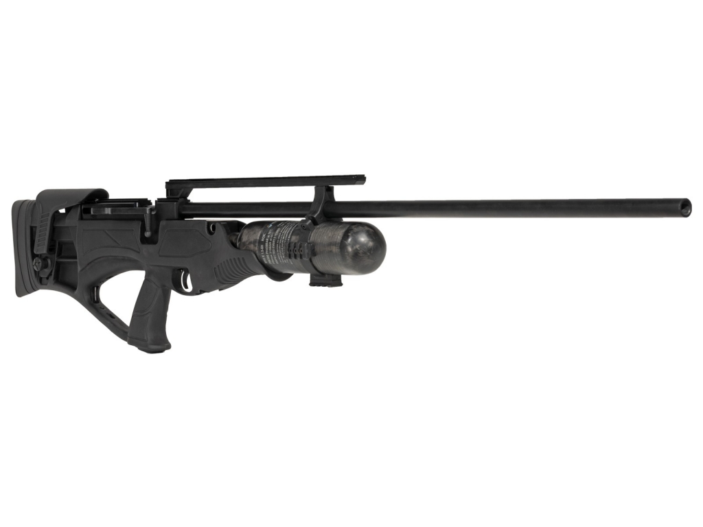

800FPE!! I might just have to have one of these
1579891196_8343242955e2b39fc3ab9a1.50166295_PY-5156_Hatsan-Pile-Driver-Air_1579289821.jpg
https://www.pyramydair.com/s/m/Hatsan_Piledriver_Big_Bore_PCP_Air_Rifle/5156#10310
Looks pretty entertaining to me.
When will Hatsan learn? Strapping the scope mount to the bottle was a disaster in the Bully causing POI shifts. I don't see why this one would be any better.
I fixed mine by detaching the connection and mounting the scope with a series of offset picatinny risers.
https://www.airgunnation.com/topic/hercules-bully-owners-i-may-have-solved-the-flex-scope-rail-issue/
I did the same, got rid of the bottle cover on my Bully, then purchased a scope rail for a Bullmaster gun from hatsan. It looks factory, give me a sight picture to cheek weld like it came that way, and ended up making my gun more accurate in that configuration. The Bullmaster scope rail is solid, not a hollowed our channel like the Bully’s was, and is a straight bolt on like it was meant to be there.
