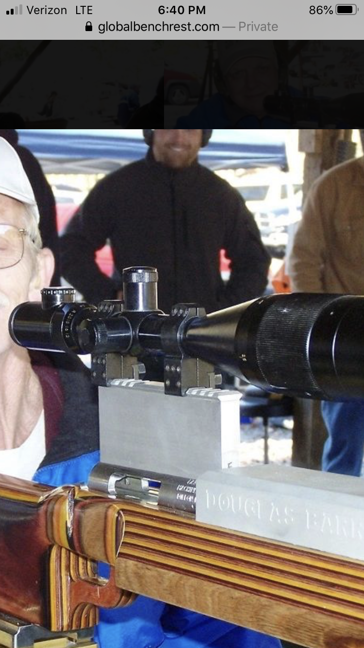

A quick question...I understand the .22 cal reference and the tripod (bipod?) looks substantial so I think I get your drift on those two items, but what is the significance of the scope being high above the barrel?
Ditto. Have you looked at the scope height on just about any Impact? Higher than the one on Nicolay's gun. I'm also a little confused over the .22 caliber and bipod comments. The RD Monsters actually have a better BC than the .30 caliber 44.75 JSB, so no disadvantage to .22 caliber. Plus the bipod looks pretty awesome to me, I'd like one…

I "see" a friggen solidly built air rifle that doesn't have a stupid regulator to fail at the worst possible time (I Had that happen)! Look how thick that receiver and barrel is, that's how a PCP built for target or benchrest should be!
F-class style bipod.
50x scope
Like in nomojo's photo, the intent of having the scope that high is to have the face off the stock and usually these set ups are free recoil so the butt of the stock won't touch the shoulder pocket.
IMO, so far PCP's are not accurate enough to warrant the free recoil set up but it can't hurt either.
We can't discount Nicolay, he has, and is, the "whole package". I bet the money, time, and tune, he has put into this "package" is much more than we even realize!
Yes, that is my favorite PCP of any I've seen so far, and by far!
Yes I was having a little fun there! With a rail mounted that high off the barrel for a airgun you would probably need about 50 MOA cant?Most Airgunners don’t practice free recoil style shooting, but all most all air rifle BR guys do, including me, the only thing that touches the gun is literally my trigger finger! (of course airguns don’t really recoil much!) but it’s still Important to make sure the gun tracks the same every time with adjustments etc. just as a added point that’s one of many reasons why I love the Thomas BR rear buttstock bag rest, but the truth of it all “IT’S NOT WHAT YOU SHOOT BUT HOW YOU SHOOT IT!”

yes ..sorry I thought it looked high but center cut comment.. had me look at my impact and its high as well..so my bad
