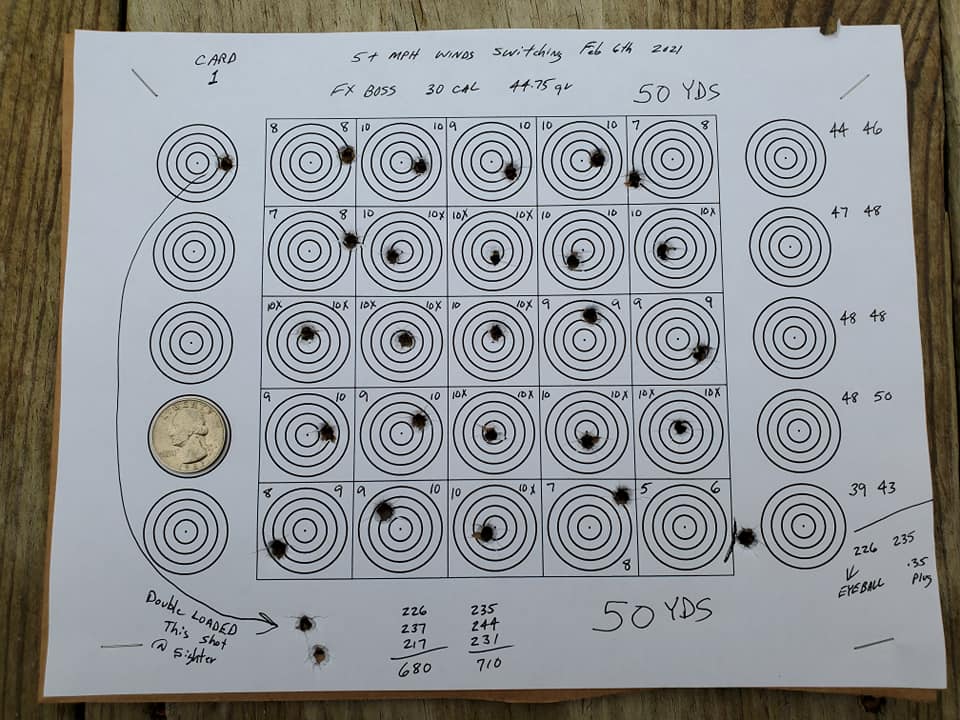

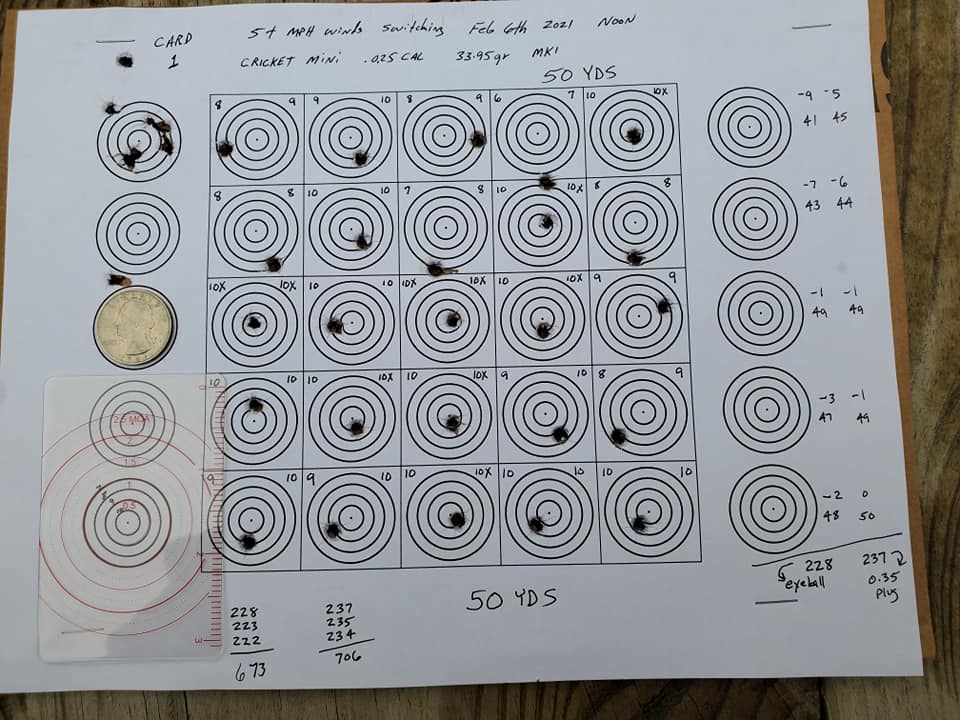

50 yds three cards each FX Boss barely beat the Cricket .25 Mini 710 to 706

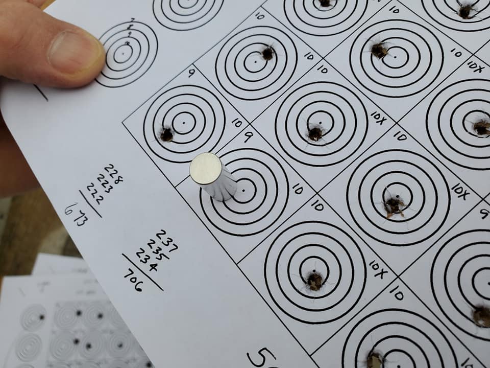

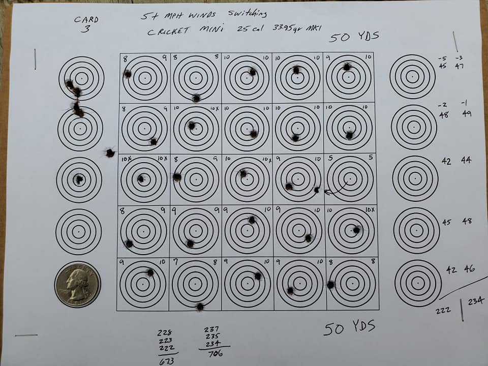

I printed out some of Michael Niksch's 50 yd sampler targets and stapled them to some cardboard backing for my first trials at Mike's targets using his .035" scoring plug. I just eyeballed my score prior to actually using the plug just to help get an idea of the difference. I used the plug with the 0.25 shank for the Cricket and the 0.30 shank for the Boss. Jotted down my eyeball score in the left corner of each bull and the plugged score in the right corner. I'll refine this as I go. Figured it might help with some research with keeping up with the eyeball test versus the plug test?

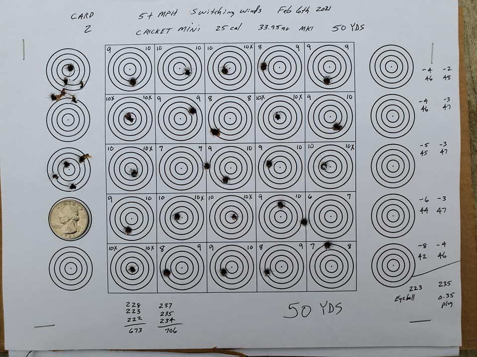

I shot the first 3 cards with the custom .25 cal Cricket Mini using the 33.95 gr MK1 jsb's at roughly 910 fps. Winds were blowing well over 5mph and switching side to side and front to back like they usually do in my back yard. Didn't use any wind flags. Doesn't seem to do anything but confuse me and aggravate the hell out of me when I guess it wrong! LOL Anyway I was just happy to get over 700 points with the plug. Gonna be a lot of work for me to hit the 725 mark?

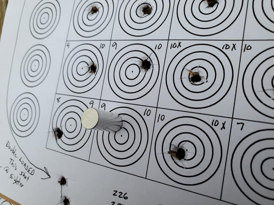

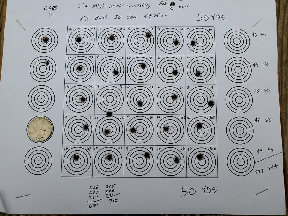

I shot the next three cards with the FX Boss spitting the 44.75 gr about 875 fps. I think the winds were getting worse, but it gave me a break on that 2nd card. That was today's best with a 244 plugged. I was shooting standing bench with rear bag and el cheapo atlas clones on both rifles. Not tethered. I was using my Ayrtekk Booster to fill the guns and was filling them just a tad more than I would usually fill them.
Anyway here's the evidence of the crime! LOL

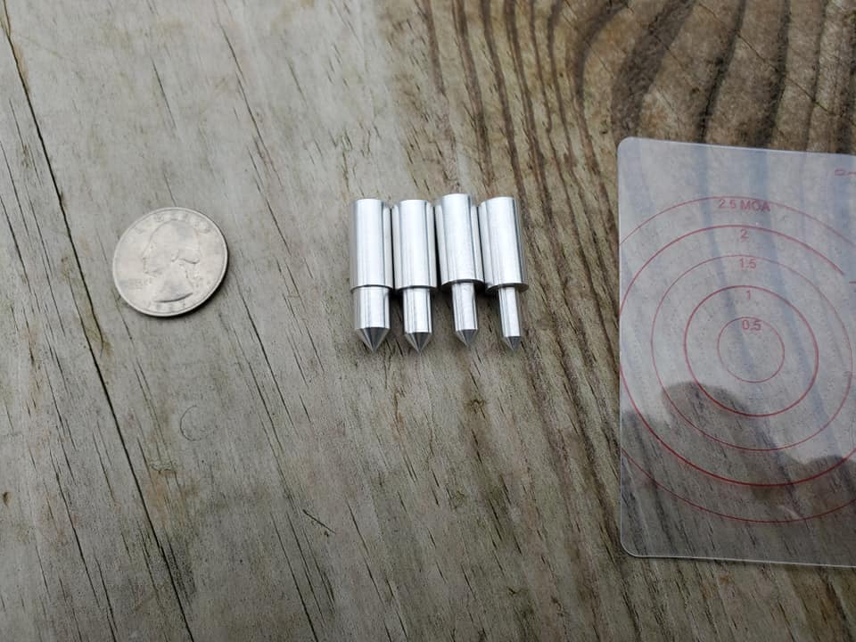

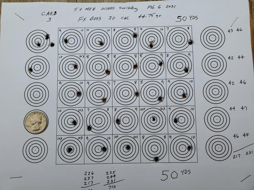

Here's the three cards for the Boss with a little picture of the four caliber 0.35 plugs shanked from .177 to 30 cal
Oh that reminds me. When I was shooting my first sighter with the Boss I accidentally double loaded it. I was aiming at the top left sighter when I pulled the trigger. It dropped a good six inches with that extra pellet in there. I got lucky I didn't mess up my shroud?

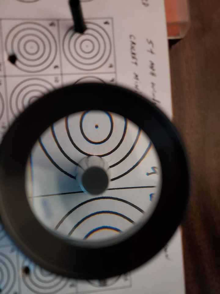

OK, after getting out my magnifier and learning a little better how to score, my scores increased just a little and even though I didn't mention the x count they decreased as I learned the whole dot has to be covered by the 0.35 plug. I had given myself the lower score previously since I had doubt in my vision without the magnifier? So the magnifier proved for what I was hoping for but wasn't sure to give myself credit for?
Cricket gets 237 w/7x, 236 w/7x, 236 w/4x for total of ....709 with 18x
Boss gets 236 w/10x, 244 w/9x, 231 w4x for total of ......711 with 23x
The Cricket had very consistent cards I might add
Nice shooting Fuss!!!
Oh, and for got to mention I was using the magazine on both guns and that last target with the Boss, the wind was blowing so bad on that third and final card that I was holding on the 7 ring to the left of the bull and it was blowing the shots to the right from bull #7 to bull #17 when it decided to switch on me.

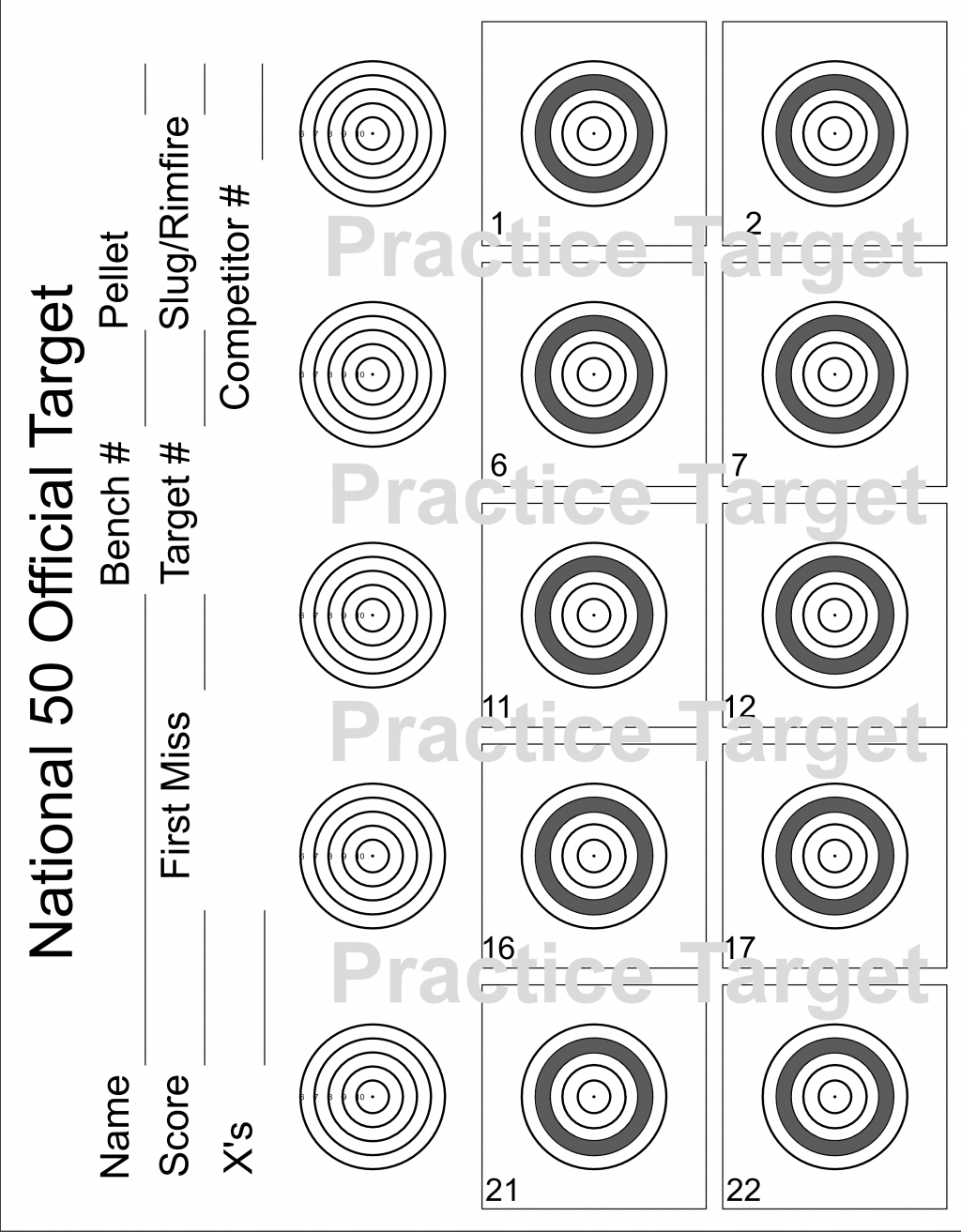

The National 50 target has bigger rings but shares the same x dot. The bigger rings combined with .350” scoring plugs for the pellet class and the ability to accommodate up to 30 caliber is going to make guys much happier and scores will be much closer overall. We have had nothing but positive comments from those that have tried the new target and scoring system.

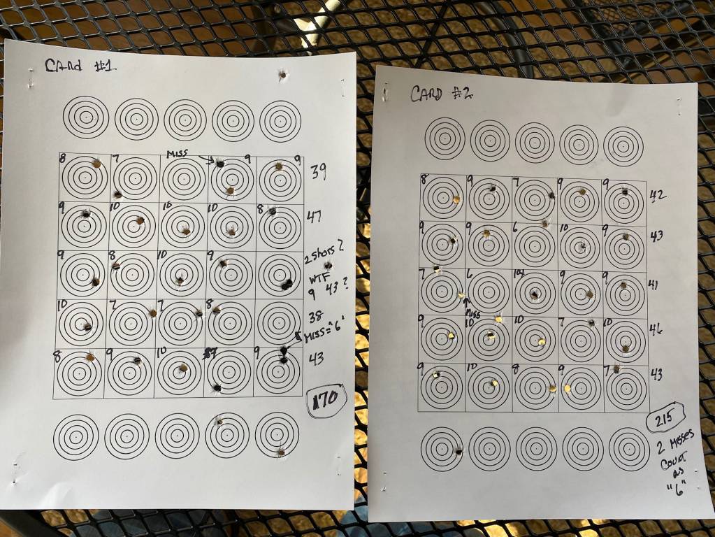

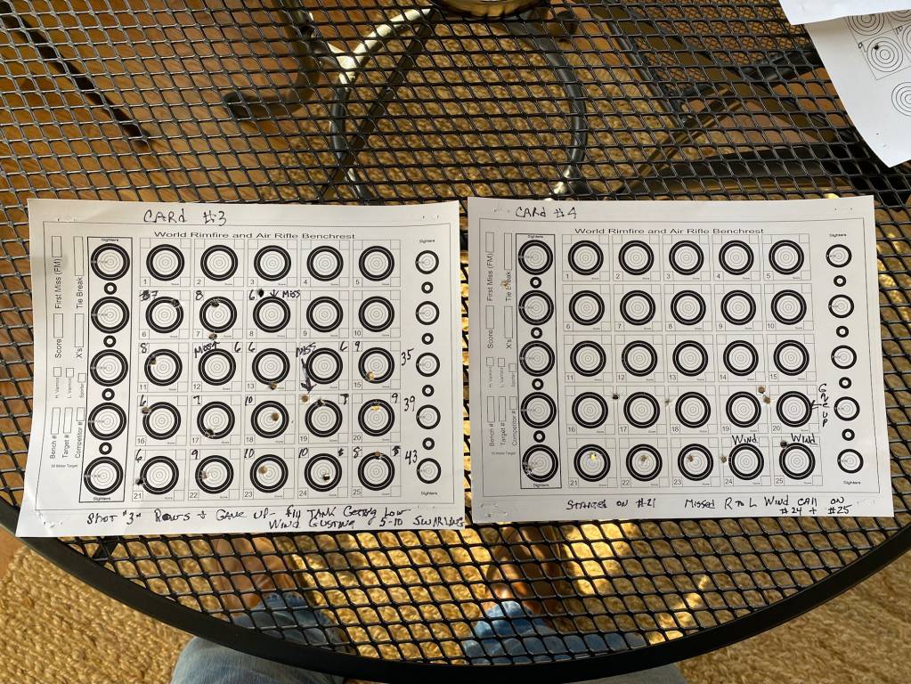

Here is the "The Good, the bad, and the UGLY!" Today, it was just ugly!
OK, let me get my excuses out of the way first. My printer has Mike N's targets at .25", .50", .75'' and 1" for bull diameter. i.e., 10 ring, 9 ring, 8 ring and 7 ring. Too small, not sure why it did not print with correct larger ring sizes. I printed at 100%.
Wind was 5-10 mph and I should have stayed home. Yes, these WRABF targets are hard to use with air rifles. I did not use my .35 cal scoring plug and as you will see had some misses, which I counted as "6's." If you look closely at the cards, you will see that with my 10's and 9's I was getting the hang of the wind call with those bulls. You will also see how I was not reading the wind well with the mostly 8's, some 7's and several misses or "6's."
I have a new to me Taipan .25 long and it is a very accurate squirrel gun for me up to 50 yards mostly ( that's as far as I dare....). I also had a few good 5-shot group outings at 50 yards with it, but average is somewhere between 1/2 and 3/4" group sizes at 50 yards. Closer to 3/4" I think. However, I tried it at the range the last few outings at 50 yards and today was my first time using Mike N's modified 50 yard BR targets .. Humbling with a capital "H!" I am going to do this again with my Safari .22 HP and RAW HM1000X .22 HP rifles, which really are my 50-100 yard BR air guns. We'll see how that goes at some future outing.
re. Taipan -- Shooting JSB Exact King 25g at around 920 FPS. The gun has been pretty accurate at 50 yards, but I have yet to test in no/slight wind conditions yet, so I really don't know how accurate just yet. I am going to jack up the speed dialer and try and get the 33G pellets to around 900 FPS if I can. May help a bit more in wind. Not sure about slug sizes yet with Taipan.
The cards sucked, so get ready for some laughs!
Tom, the wind definitely humbles me. That second card looks good. I had a 217 with the eyeball score and that was with the .30 cal Boss and I know it's a shooter in no wind?

I printed out these target sample left/right from Mike's Nat50 site, but they came out just a little undersized since it was printing from photo instead of PDF?
Hope you don't mind if I share Mike, I'll delete them if you prefer.
From Mike's new website http://national50.org/target/

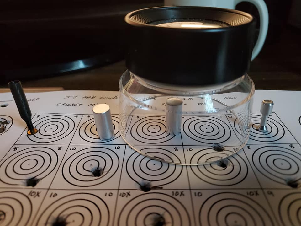

Hey guys after talking to Mike today, you might want to invest in a magnifier for those shots that are really close to the line. Make sure you don't see any white between the plug and the black line. I used mine just now on one of my targets and all was good except I called an x that I didn't deserve and the magnifier caught it. Was hoping to change an 8 to a 9 score on another bull, but the magnifier confirmed my 8 score as I could see the white really good with the magnifier.
I have a 7 power. Mike suggests an eight power. I've had mine for close to 5 years and can't remember where I got it. Maybe someone will chime in with a link with a good one to use.
Here's a couple pics of mine.
