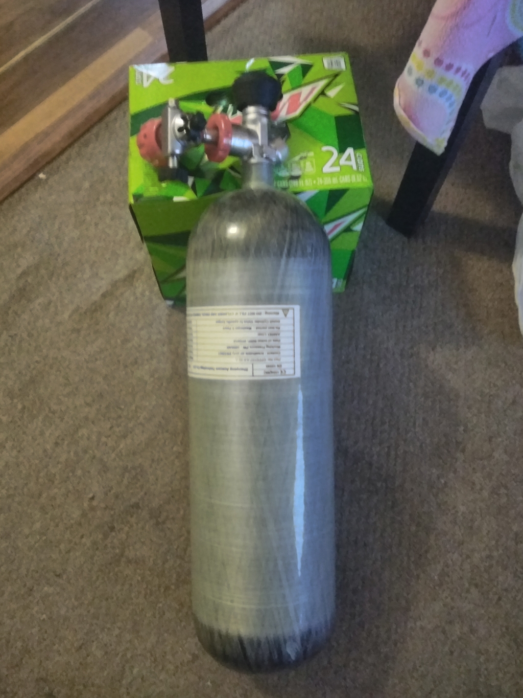

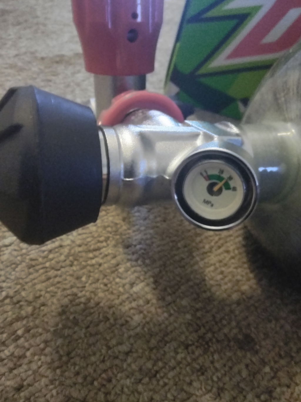

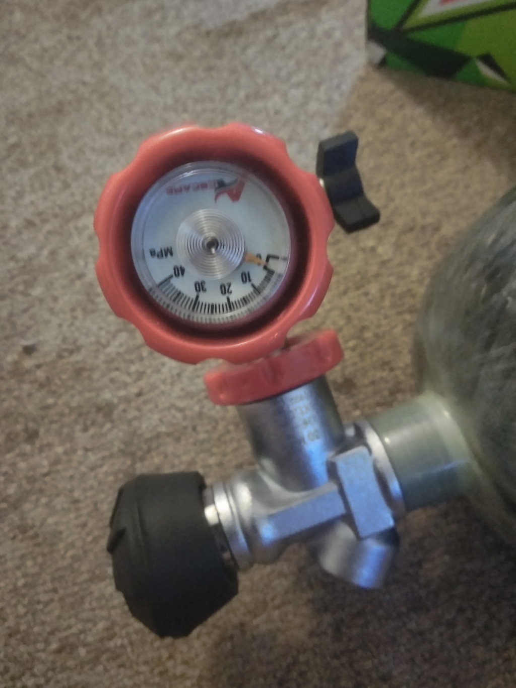

Here's what my acecare tank looks like. Mine is the 6.8l. you can see the size of it compare to the soda box. It has two gauges. Smaller one reads pressure in the tank. The larger gauge reads output pressure going into the gun. It has an male quick disconnect fill on the valve. So you just hook up with a female quick disconnect like you would on a impact or marauder.
Yes, I have a Shoebox, also a Benjamin small tank. I would like a larger tank, but don't want a "full sized" one. The 6.8L looks like a 45m, or 66cuft tank. I would like to see a pic if the 3L. Thanks for the pics, 2fast.

I bought one of the 3 liter Acecare tanks a couple of years ago. Like others have said, the Acecare tank quality is just as good as any other brand. The 18mm x 1.5 neck thread size means you can't use a typical U.S. threaded 14 x .875" valve. The valve on mine looked like the SCBA fireman's valves which show the remaining tank pressure in MPa, which was a plus. I ended up selling it to a local airgun shooting buddy. I own a compressor and found that the 3 liter size didn't give me enough fills before needing to be refilled itself. After buying and selling every tank size there is from 9 liter down to 1.8 liters, I've settled on an Omega 6.8 liter sized tank and valve as my absolute favorite and last tank set I'll ever buy. The carry size is perfect and the number of fills is more than adequate. I especially like the push button bleed valve and the extra flexible kink proof hoses that are exclusive to the Omega brand tanks.

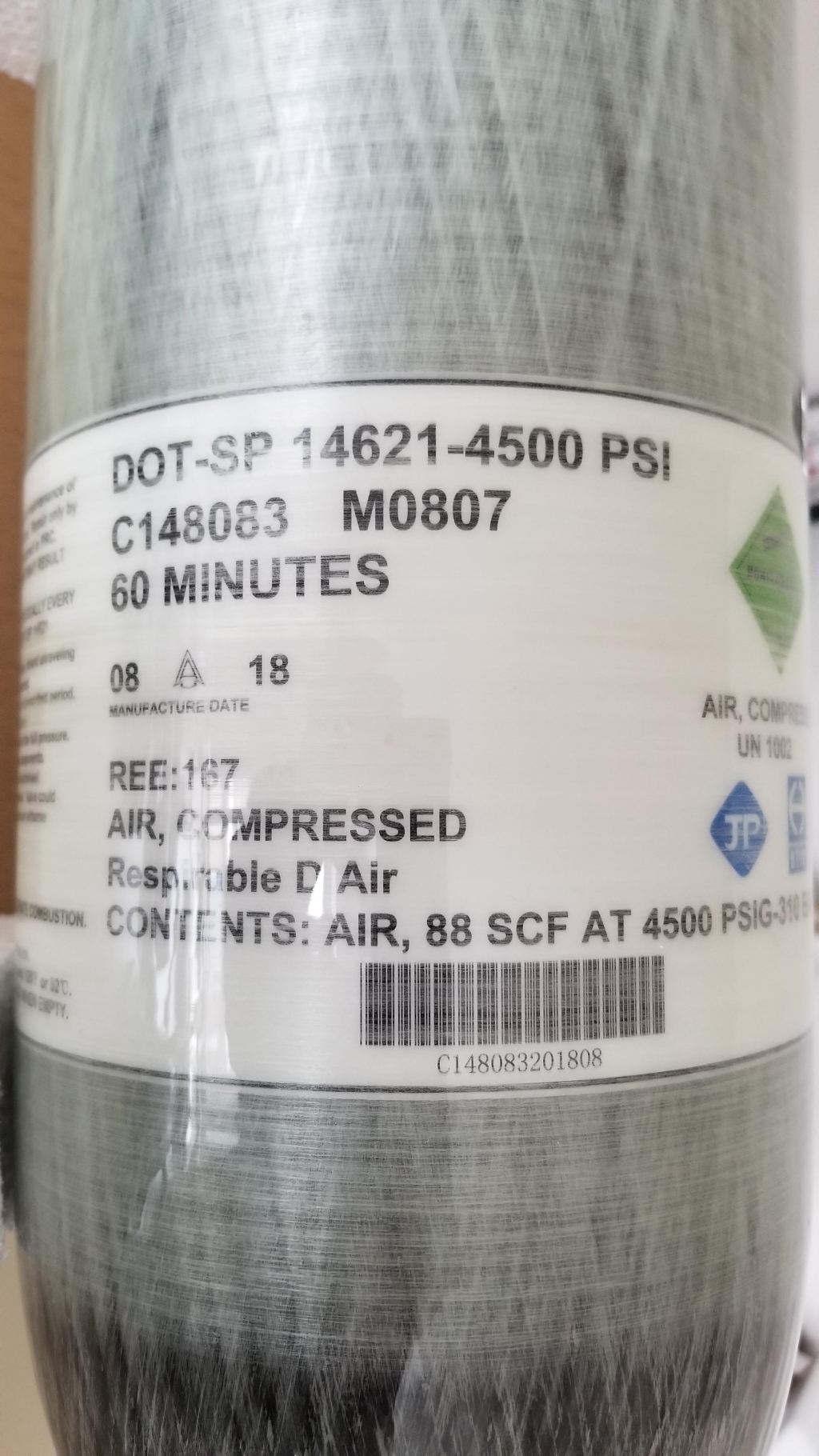

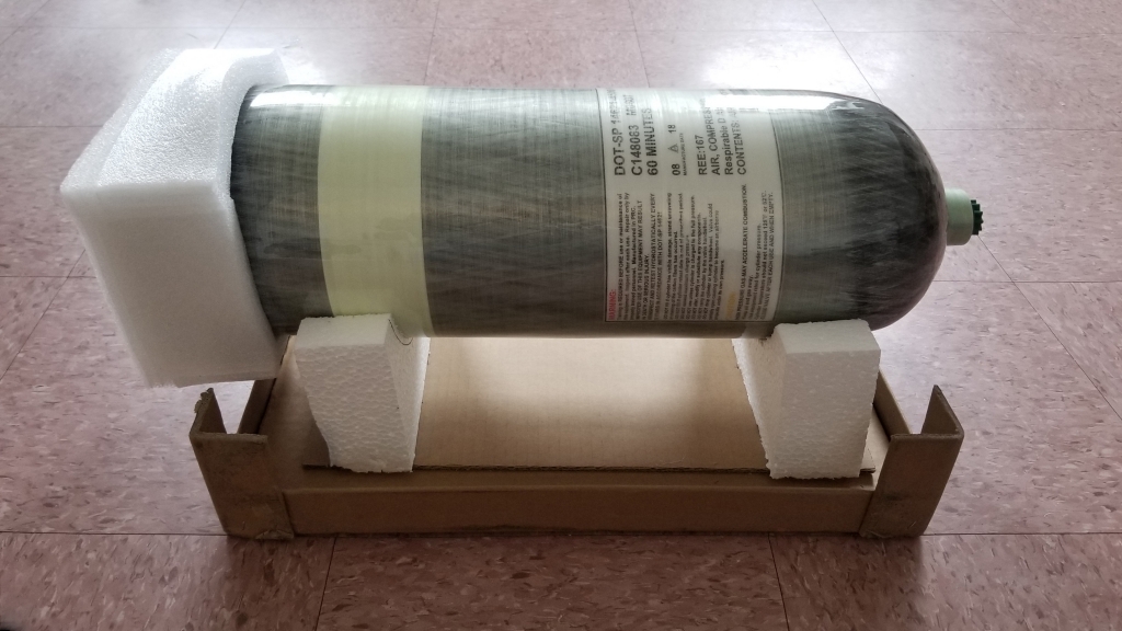

Last year, I stumbled across a seller for sever sizes of the China made carbon fiber tanks..
After a lot of research, and seeing just how much quality was put into their production,
I jumped on an 88cf version without hesitation. DOT Approved and the fit & finish rocks..
Best of all, I think I only dropped like $300.00 for it.
I'm in the middle of a project-build and needed a mini cf tank,
so also just ordered another one of these in the .22 Liter size.
If I remember, I'll pop back in with thoughts about that one too.
