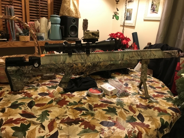

I just put a Pitbull DePinger and a Pitbull Long Moderator on my Bulldog, the Long did a ok job at making it ear friendly but if you really want to be backyard friendly I would go with a DonnyFL Emperor, I know what the Emperor will do being I have one already and I have only heard on video the Mega but if I had a extra 250 bucks i would go with the Emperor V3 but if on a budget the 200 dollar Pitbull Mega would be just fine plus the Mega would look more natural on the Bulldog then the round 10” Long Emperor.
1545297816_15793687665c1b5f98b3f983.44881521_226809A3-F27A-4AE3-8BF6-CFB8A203B111.jpeg
