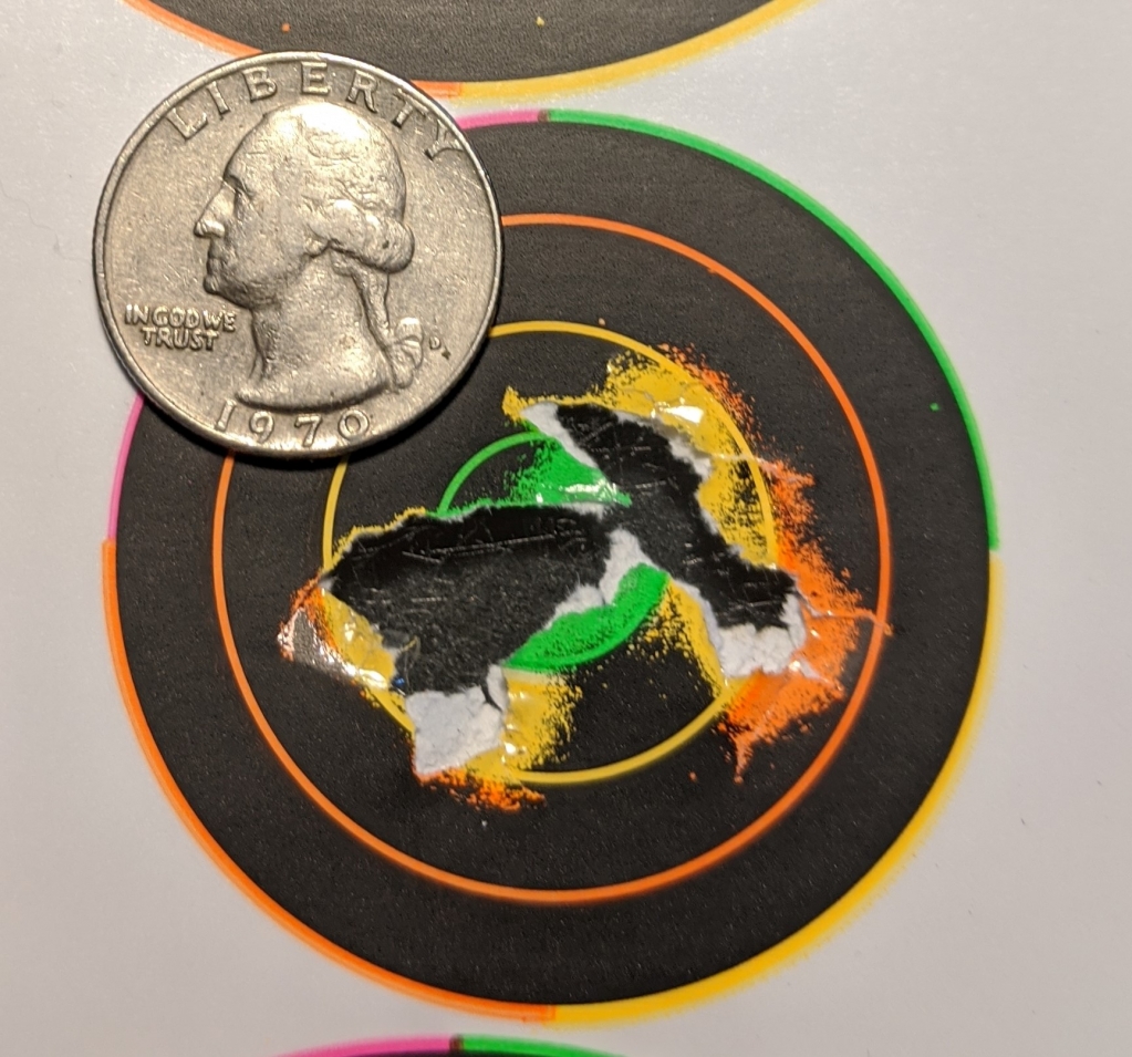

After two more adjustments I'm at 110bar on the reg and flinging led at 880fps, with groupes like this at 85 yards
Can't say I understand it, but I like it!

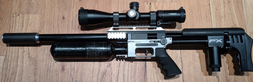

The gun is the model just prior to the X coming out, whatever that is. ST?
It's a 600mm barrel and I used both the FX silencer and the Neil Clague.
Ernest power tuned it, but it failed (main valve) pretty quickly. While it was getting fixed for that it got the MkII upgrades.
It's got the extra plenum.
The gauges are wika and were validated by Ernest prior to install.
