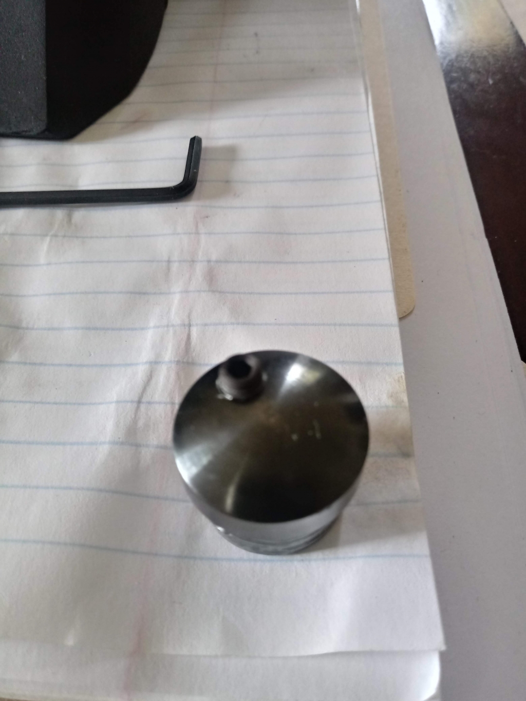

This is the hammer preload adjuster. I used a scope mount stop pin for adjustment.
