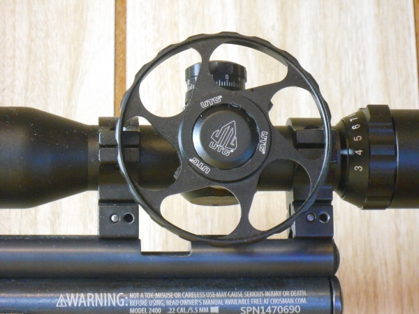

 While it is a compact optic,one aspect I do not like is the short area available to mount your rings. On this 2400kt I have used narrow BKL rings and you will notice the front ring is moved forward until nearly touching the bell and yet the scope needs to move an inch or more rearward to be comfortable. Cantilever rings or maybe a single double clamp ring on the front would be a option or better yet a scope with a longer tube,.It is not a problem on this gun as I only use it when mouse fart stealth mode is required. Forgive the crappy photos .
Reactions: fishinwrench
While it is a compact optic,one aspect I do not like is the short area available to mound your rings. On this 2400kt I have used narrow BKL rings and you will notice the front ring is moved forward until nearly touching the bell and yet the scope needs to move an inch or more rearward to be comfortable. Cantilever rings or maybe a single double clamp ring on the front would be a option or better yet a scope with a longer tube,.It is not a problem on this gun as I only use it when mouse fart stealth mode is required. Forgive the crappy photos .

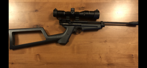

i'm about to find out , fishin wrench....i just traded a guy for a bug buster (he had it on a .177 hatsan 65, so i traded him a 4-16x40ao air attack).... i'm gonna put it on my black 1322 and put a shoulder stock on it....probably just temporary , tho. seems co2 is a better way to go (more power) if temperature is over 65-70 degrees... - raneman .

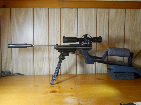

I have had a few of these. I like to use the older Bug Buster 3-9x32 with the forward AO. But I believe the sidwheel version is the same dimensions. I use LOW profile rings and end up with about a business card amount of clearance between the AO and barrel. I don't need to use a cheek comb/riser in this configuration. Unlike when the same scope is used on a PRod you need med height or taller to mount that same scope, then you have to use something to get your cheek up higher. ATI makes a riser piecre for a skelotelonized/folding SKS stock in the sub $20 range, just slips over the stock and is adjustable up, down to and fro. Like deke says not much to and fro adjustment, but I've used this setup on at least a dozen 13xxx. I think the little bug buster is the best scope out there for this little.gun what ever that is worth.
I would say the next size up the 4_12x44 with the 30mm tube is to much scope for that lil gun. I put one on one of mine thats set up with a 24" barrel to get a feel for it, just throws the balance way off. I felt the same putting a full length scope even with a 1" light tube on my shorter barreled guns felt just as unbalanced
