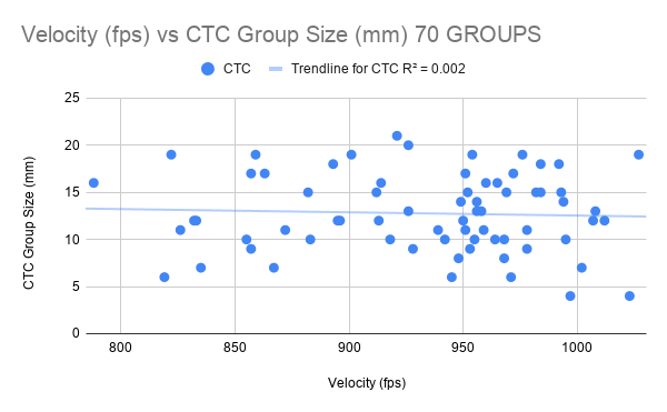

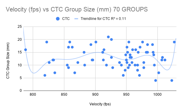

Woke up to dead calm conditions so shot 35 more groups. My gun had trouble getting over 1000 fps per second this morning as pressure of the tank I was tethered to dropped below reg pressure. I may start making finer adjustments to my hammer spring in the lower velocities and larger adjustments at the higher velocities to try to keep the data more spread out. As you can see I am starting to get some clumping of data around 950 fps.
After 70 groups, the linear correlation is still very weak. No real changes here.
Our three dips from the previous data can still be seen at about 860, 950, and 1020 fps. As mentioned above, none of my groups averaged over 1000 fps in this test batch, so that section of the curve is unchanged.

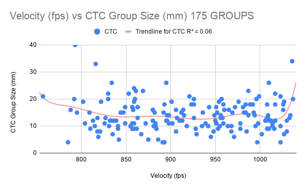

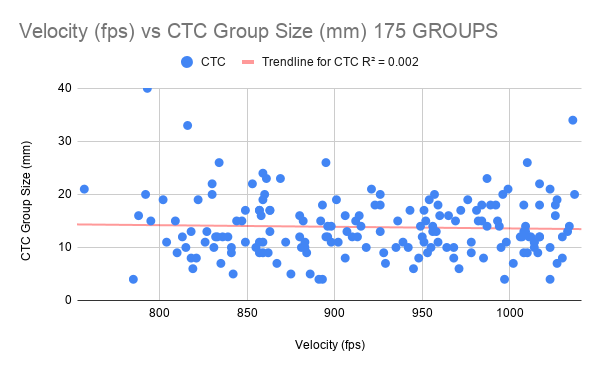

Was lucky enough to have great shooting conditions both last night and early this morning and collected 105 more groups worth of data. We are almost to the halfway point now.
As you can see, the linear data has been consistent throughout the experiment so far and shows changing velocity/spin speed of the slug doesn't affect group size.
The 8th degree polynomial is also flattening out. It is getting harder to make the argument that there is a velocity tested that is resulting in tighter groups.

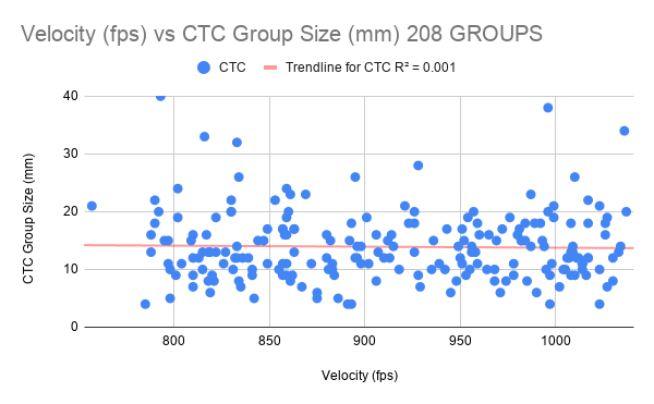

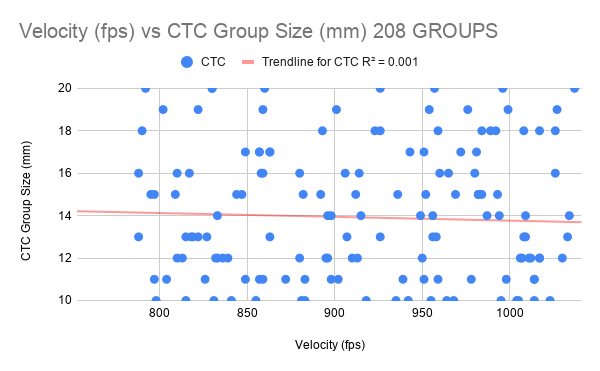

Added more data. We are not quite to the half way point but after 209 Groups, this is what the group distribution looks like:
The data couldn't be more flat. It looks like the slugs don't care what speed you shoot them at up to about 1025 fps. Maybe they like being shot even faster than 1025fps (or spun faster than 41,700 RPM) but I wouldn't bet on it. Lets zoom in on the trendline and see if we can drill down the average group size the data says my Veteran is shooting the .216 diameter KO slugs at.
As you can see, the trendline shows that average group size is 14mm at all tested velocities.
The 8th degree polynomial graph is also flattening out and looking much like the linear graph. This is to be expected if the data truly shows that changing velocity doesn't affect group sizes.
